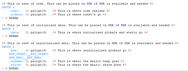

  • Hi Thinh,
    In the linker.cmd file add the below line to the MEMORY portion of the file
    DDR_MEM_MCU0 : ORIGIN = 0x80000000 , LENGTH = 0x80000
    Then you would assign the lines for SECTIONS to the defined DDR mem.

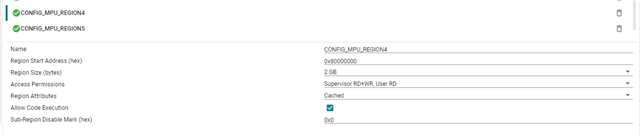

  • Just to be sure, can you open the syscfg file in the SysConfig tool and then check the config under MPU ARMv7?
    The bootloader and hello world application should have an MPU config for the DDR space if it isn't there already.
  • Also, you can check if DDR is configured successfully by checking the 0x8000 0000 memory address in the CCS Memory Browser. After the bootloader runs the DDR should be configured so within CCS connect to an R5F core and test whether the 0x80000000 address is writable.
  • Hello Ahmad,
    Thank for your remind I have checked my FW It can run on DDR in debug mode as image
    But when I flash fw binary in NOR, It does not operate. I didn't know. I will check my process.
    Thanks for your suggestion.

    Another case, I modify the linker.cmd file to M4F firmware execute on DDR by below:
    /* make sure below retain is there in your linker command file, it keeps the vector table in the final binary */
    --retain="*(.vectors)"
    /* This is the stack that is used by code running within main()
     * In case of NORTOS,
     * - This means all the code outside of ISR uses this stack
     * In case of FreeRTOS
     * - This means all the code until vTaskStartScheduler() is called in main()
     *   uses this stack.
     * - After vTaskStartScheduler() each task created in FreeRTOS has its own stack
    --stack_size=16384
    /* This is the heap size for malloc() API in NORTOS and FreeRTOS
     * This is also the heap used by pvPortMalloc in FreeRTOS
    --heap_size=32768
    SECTIONS
        /* This has the M4F entry point and vector table, this MUST be at 0x0 */
        .vectors:{} palign(8) > M4F_VECS
       .text:   {} palign(8) > DDR_MEM_MCU0     /* This is where code resides */
        .bss:    {} palign(8) > DDR_MEM_MCU0     /* This is where uninitialized globals go */
        RUN_START(__BSS_START)
        RUN_END(__BSS_END)
        .data:   {} palign(8) > DDR_MEM_MCU0     /* This is where initialized globals and static go */
        .rodata: {} palign(8) > DDR_MEM_MCU0     /* This is where const's go */
        .sysmem: {} palign(8) > DDR_MEM_MCU0     /* This is where the malloc heap goes */
        .stack:  {} palign(8) > DDR_MEM_MCU0     /* This is where the main() stack goes */
        /* General purpose user shared memory */
        .bss.user_shared_mem (NOLOAD) : {} > USER_SHM_MEM
        /* this is used when Debug log's to shared memory are enabled, else this is not used */
        .bss.log_shared_mem  (NOLOAD) : {} > LOG_SHM_MEM

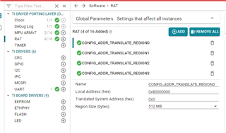

  • Hello Thinh,
    As you were able to run R5 binary with DDR, I assume when you are running the M4 application you are following same steps to configure DDR and your DDR is configured correctly.
    So for M4F access issues - have you configured RAT like below for enabling access from M4?
    Prasad
  • Hello Prasad,
    As your RAT configuration of M4, I saw the helloworld of m4fss0_0 nortos in mcu_sdk 8.0 has already configured. So this issue is not resolved.
    I think that to M4F run on DDR, I need to modify execution region of MPU_ARMv7 for mapping to DDR but do not overlap on the first RAT region0.
  • Hello Prasad,
    In order to the M4F firmware run on DDR, I modified the linker file and sysconfig file as below:
    Linker:
    Entry point and vector table sections stil keep on RAM
        M4F_VECS : ORIGIN = 0x00000000 , LENGTH = 0x00000200
    //    M4F_RAM  : ORIGIN = 0x00000200 , LENGTH = 0x0003FE00
    Other sections allocated on DDR at 0x90000200 (maybe change 0x90000000)
        M4F_RAM  : ORIGIN = 0x90000200 , LENGTH = 0x0003FE00
    In the sysconfg file:
    MPU_ARMv7:
     CONFIG_MPU_REGION1:
       baseAddr = 0x90000000;
       size = 256KB
    RAT Regions:
     CONFIG_ADDR_TRANSLATE_REGION0: (do not overlap on MPU region1)
       localAddr = 0x80000000
       sysAddr = 0x0
     add one more Translate region
     CONFIG_ADDR_TRANSLATE_REGION4
       localAddr  = 0x90000000;
       sysAddr = 0x90000000;
       size = 256KB
    Now my firmware works well. I only tested on gpio_blink_led and helloworld examples.
    cheers,
    Thinh
  • Hi Thinh,
    Thanks for letting us know the fix. We see earlier RAT configuration of 512MB was conflicting for you so you had to split into two.
    Thanks, Prasad
