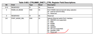

Dear TI expert.
Would you please help clarify what is QSGMII_Sub? what is the difference between QSGMII and QSGMII_Sub?
thanks a lot!
yong

  • Yong,
    Below is the explanation I received from the ethernet expert.
    "QSGMII is a quad-port of SGMII onto a single SERDES lane. That is 4 ports of the switch can be merged onto a single lane of the SERDES.
    The QSGMII port specifies which SERDES lane is used for the QSGMII module.
    QSGMII_SUB is a subordinate port of a QSGMII SERDES lane. The QSGMII_SUB does not use or require a CPSW SERDES lane as it is a subordinate port to a QSGMII.
    So if ports 1-8 were
    1 QSGMII_SUB
    2 QSGMII_SUB
    3 QSGMII
    4 QSGMII_SUB
    5 QSGMII_SUB
    6 QSGMII_SUB
    7 QSGMII_SUB
    8 QSGMII
    The SERDES port for the CPSW port 3 would be the base lane for the first QSGMII, and ports 1, 2, and 4 are the three other subordinate ports for the first QSGMII on CPSW port 3 SERDES link.
    Ports 5, 6, and 7 are the subordinate ports for the second QSGMII on CPSW port 8 SERDES. That is only CPSW port 3 and 8 will use SERDES lanes.
    That is the QSGMII can be placed on any CPSW port SERDES lane, and the other ports can be put under that port.
    The first 3 QSGMII_SUB ports will be placed on the first QSGMII[0], that is if CPSW ports 7 and 8 are configured for QSGMII and all the rest are for QSGMII_SUB, ports 1, 2, and 3 will be attached to CPSW port 7 QSGMII SERDES lane."
