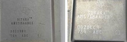

    Can you mention your SDK version, SR of the two ICs and OS.
  • Hi Sir
    SDK  :  processor-sdk-linux-04.01.00
    kernel  :    Linux version 4.9.41-gc6c5f1afae
    BOOT LOADER2017.01-gf8adbe225f
    New and old IC are the same AM5718AABCX, hardware version is 2.0.
    What do you mean "SR"?
    By SR I mean Silicon Revision. Can you mention the Silicon Revision of both IC and also, which silicon revision is  working and which one is not.
  • Hi Sir
    New and old IC both are the same AM5718AABCX, silicon version is 2.0.
    Daniel

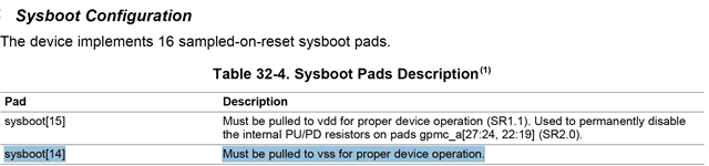

  • Can you confirm that sysboot[14] pulled low on the board, per TRM:

    Sysboot[14] is pull low
    Sysboot[15] / GPMC_D15 is CTRL_CORE_PAD_GPMC_AD15 on the TRM(spruhz7i)?
    The Reg CTRL_CORE_PAD_GPMC_AD15 value is 0x 00 05 00 00 which is printed on the function __autoboot() from the uboot.
    Daniel

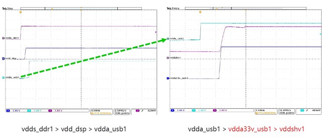

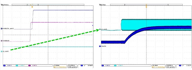

  • Thanks for checking the MMC errata. A power integrity issue on any of the IO power supply rails could also cause the issue. Can you probe the IO power supplies to the SoC to confirm there are no dips below the minimum allowed voltage?
    Also, what is the timeout value of LDELAY? Can you try increasing this value to give more time for it to complete?
  • Hi B.C.
    I'll have to discuss with our EE engineer to see what we could do about the power rails.

  • Hi B.C.
    voltage is normal.
    Could you give me some suggestions?

  • Hi Kyle
    The issue is follow IC. Could you give me some suggestions?
    Daniel
  • Daniel,
    Our main suspicion is that one or more of the power rails to the SoC are operating out of spec.  Initial focus should be on vddshv*.
    The isolation ring will fail to isolate/de-isolate if the IO power supplies are out of spec.
    Can you collect waveforms of the power supply sequencing during initial power on as well as the DC voltage when you execute the isolation software?
    Kyle
