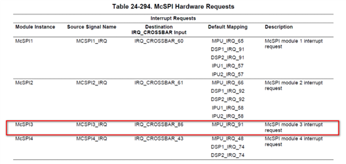

Dear Champs,
How SPI3 can be used in C66x DSP of AM5728?
Should there anything to be done to use SPI3 in DSP?
My customer is trying to use SPI3 in C66x DSP, but there was no response in RX.
As the same code works well for SPI2 in DSP, they want to know if there is anything should be done to use SPI3 in DSP.
They found IRQ for McSPI3 was connected only to MPU in the TRM as below, but they failed to change it to DSP.
They tried to use it in DSP using below, but there was still no response in RX.
http://software-dl.ti.com/processor-sdk-rtos/esd/docs/latest/rtos/index_how_to_guides.html
Could you please check below their source?
McSPI_test.zip
