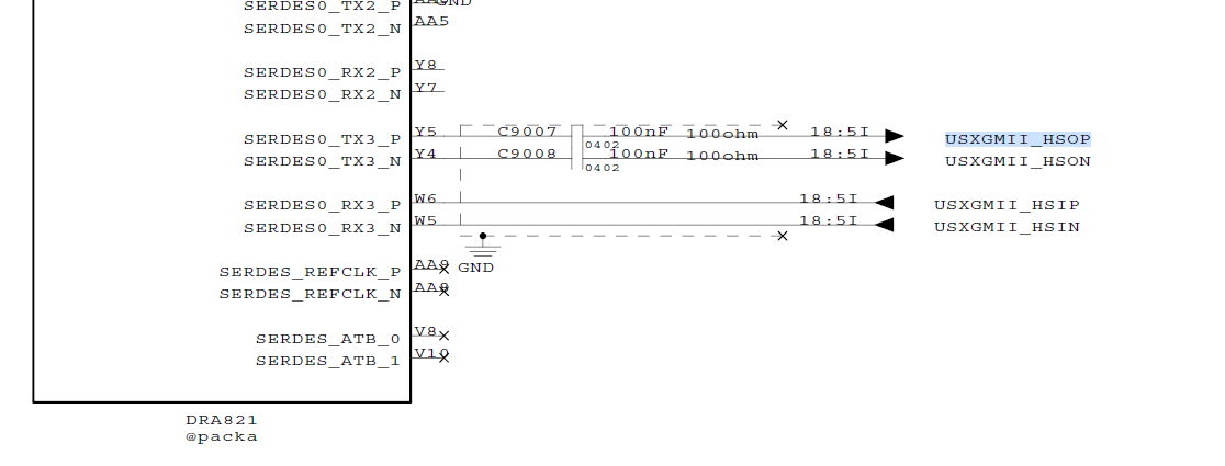

we are try to enable USXGMII on MAC port 2 (CPSW5G has MAC port 0~3). Customer wants to use MAC port 2 to MAC2MAC connect to external Switch RTL9705.
May I ask how to do it on TI SDK V7.3?
here is the HW design. MAC port 2 + SERDES0 lane3.
actually, We found no right phyType in Board_serdesInitParams().
if(phyType == CSL_SERDES_PHY_TYPE_SGMII)
else if (phyType == CSL_SERDES_PHY_TYPE_QSGMII)
else
$RTOS_SDK/PDK_j7200_07_03_00_29/packages/ti/board/src/j7200_evm/board_serdes_cfg.c
May I ask how to configure below paramsters?
laneParams->pcieGenType
laneParams->linkRate
thank you so much!

  • Hi Yong,
    XGMII is not verified in software. If you see the driver, the support is very limited in the driver with few mentions here and there.
    It's unlikely to be supported with just a patch and will require dedicated support and testing in SDK.
    Vineet
  • There is no PHY support in the EVM for this so we cannot verify this functionality. Please reach out over email to discuss this.
    I will close this ticket.
