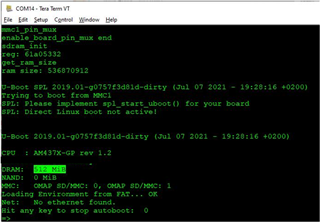

I have a design based on an AM4372x with 2 RAM memories of 512MB each. The output of the system there are 512 MB, please see the picture.
I don't know if the system should say 1GB, or is it normal that it shows 512MB.
Is this normal or the system recognizes only one RAM and in that case I have a configuration problem?
Attention: Both memories share the same address bus (A0-A14) and each memory has 16bits on the data bus (D0-15 -> RAM1, D16-31 -> RAM2). This is why I think that maybe this system output is normal.
Thank you very much. Best Regards.

    DDR size is "dynamically" determined in SPL/u-boot via calling get_ram_size() as listed below:
    where dram_init() in "/arch/arm/mach-omap2/am33xx/board.c", and get_ram_size() in "/common/memsize.c"
     * Check memory range for valid RAM. A simple memory test determines
     * the actually available RAM size between addresses `base' and
     * `base + maxsize'.
    long get_ram_size(long *base, long maxsize){}
    int dram_init(void)
    #ifndef CONFIG_SKIP_LOWLEVEL_INIT
    	sdram_init();
    #endif
    	/* dram_init must store complete ramsize in gd->ram_size */
    	gd->ram_size = get_ram_size(
    			(void *)CONFIG_SYS_SDRAM_BASE,
    			CONFIG_MAX_RAM_BANK_SIZE);
    	return 0;
    where for AM437x EVM (2GB DDR)
    - /include/configs/am43xx_evm.h
    #define CONFIG_MAX_RAM_BANK_SIZE	(1024 << 21)	/* 2GB */
    - /include/configs/ti_armv7_common.h
    #define CONFIG_SYS_SDRAM_BASE		0x80000000
    On DDR connection options, have you cross-referenced section 5.12.8.2 Memory Interface in AM43xx datasheet (www.ti.com/.../am4379)
    -Hong

    My question is if in a hardware like the one I show in the attached image, is it normal for the system to detect 512MB, or should it detect 1GB?

    Following up my last reply, let me use Linux SDK 6.3 as an example:
    By default, for AM437x EVM (2GB DDR)
    The u-boot log would be:
    U-Boot 2019.01-g175b3522cc-dirty (Apr 26 2021 - 15:31:10 -0500)
    DRAM:  2 GiB
    If I make one change as listed below in u-boot code:
    #define CONFIG_MAX_RAM_BANK_SIZE	(1024 << 20)	/* 1GB */
    I'm attaching the new log file with the above u-boot change, where
    DRAM: 1 GiB
    Can we check "CONFIG_MAX_RAM_BANK_SIZE" configuration in your u-boot?
    #define CONFIG_MAX_RAM_BANK_SIZE ???
    -Hong
