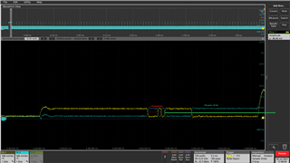

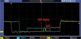

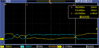

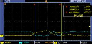

    I have captured the Frame Synchronization Packets of the 1920x720( the clock cycle is 13.36ns), and found that the format of SP is in-correct:
    ①part of the "HS Sync-Sequeence" : “00011101”(the red color), 32.80ns
    ②the time of SP: 53.76ns
    According to the above measurement, we can see that the Time(HS-Sync ) is almost equals to the Time(SP).
    But the calculation of the Time(SP) =  13.36 * 32 / 2 = 213.76ns ≈ 53.76 * 4
    Could you please confirm it?
    best wishes
    Chengwu.Tang

  • Chengwu,
    Please increase the resolution on the captures and also include the CLK lane. A few questions:
    1. Are you capturing on DAT0?
    2. Is this the only frame transmitted by the device?
    3. What is the error flag shown on the receiving sensor?
    Thanks & Regards,
    Shiou Mei

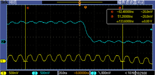

  • Hello, Shiou Mei
    Update the answers and update the captures:
    The clock lane: 133.6 / 10 = 13.36ns
    The answers are below
    ->Yes, I captured it on Data lane0.
    ->No, Just one of the frames transferred. But all the frames are the same.
    ->The rx side is the Qualcomm SA8155, and the error flag is decode error.
    best wishes
    Chengwu.Tang

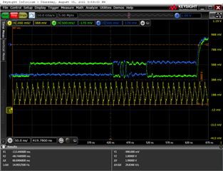

  • Hi Shiou Mei
    I have updated the capture, the CLK and data signals are on the same scope capture.
    Is the decoder error related to ErrFrameSync or ErrFrameData? The target device was only able to receive the CLK, or was it able to receive some data frames as well?
    ->They said that: the decoder error ralated to the ErrFrameSync, but the ErrFrameData is not sure, need to confirm.
    And the target device can receive the clk and the data.
    best wishes
    Chengwu.Tang
