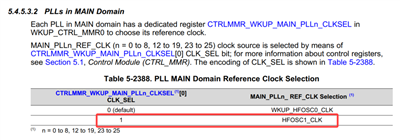

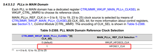

In safety manual of TDA4VM, the clock shall be configured as shown below. but when clock(HFOSC1) for MAIN domain is configured before boot of MAIN domain, the system crash and not work.
So how to configure the clock(HFOSC1) for MAIN domain correctly? Please help to confirm.
