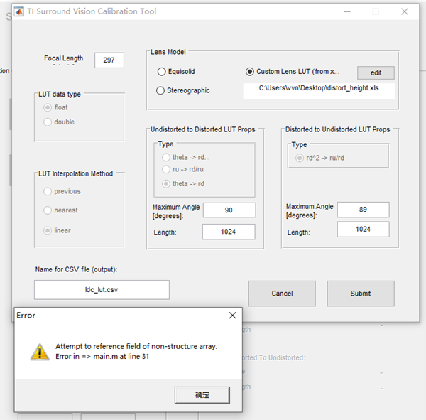

TDA4VM: manual Calibration Tool
Part Number: TDA4VM
I used 3D Surround Vision Calibration Tool according to user guide.
In step 3, I tried to use the equisolid or the stereographic model, the calibration tool can generate a .csv file.
I wanted to use a distortion function from lens vendors. I pressed "Run LUT Generation Tool" button,  and chose the “Custom Lens LUT” button and selected my .xls sheet. But the calibration tool got something wrong.
Appreciate your guidance here.
  • Here is the data in excel sheet about distortion function from lens vendors.

  • I guess it is related with length (and max angles) in "Undistorted to Distorted LUT props" and "Distorted and Undistorted LUT props"
    How about changing length = 1003 and max angles = 102.8?
