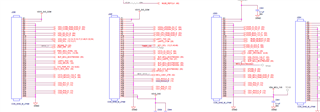

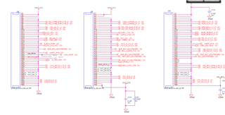

TDA4VM: Dos the CSI2.0 4L TX can work in RX mode as well?
Part Number: TDA4VM
Hi to all,
I have read on the Datasheet that TDA4VM has two CSI2 port works on RX mode and one that works on TX mode, a total of three CSI2 ports.
I have noticed that in the Schematic, the CSI2 PORT 2 was directed as RX (connector J48). In addition to CSI2 PORT 0 and 1. Is this true?
If not, why do we have three CSI2 PORTS in RX mode (COBBECTORS j48 & j52)? Please see the picture below, which shows this section on the schematic.
Yishai,
