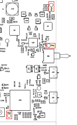

    Can you check if the 12V (TP81), 5V (TP18) and 3V3 (TP44) rails are present (highlighted below)?v  If you have 12V at TP81, but 5V and 3V3 are both dead, then it is likely the U30 regulator was damaged and needs to be RMA'd.  Link is here for repair: https://www.mistralsolutions.com/product-engineering-services/rma-form/
  • I switched to a ps that has 5A, and did the procedure described. the 12V is there but 5V and 3.3V are both dead in both power switch positions. I will fill out the RMA form

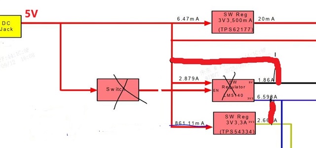

  • I think the AM64x GPEVM design has flaw, the power circuit is very easy broken. I have several brick boards on hand now.
    We made this change to make the board working again.
    1. Remove U30.
    2. Short TP12 and TP44 to provide 3.3V.
    3. Short TP18 and C66(VMAIN)  to supply 5V.
    4. Supply 5V instead of 12V to board.
