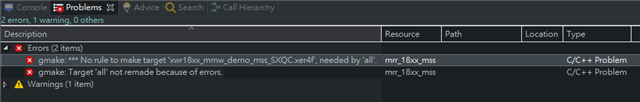

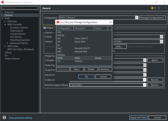

I can successfully build code when I use default configuration name "isk".
However, when I try different configuration name ("SXQC" in this case as shown in fig.1) , it shows error message (as shown in fig.2).

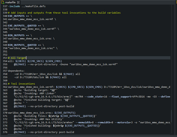

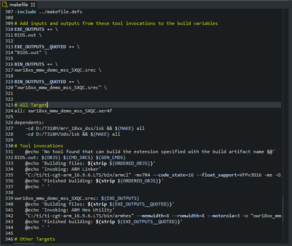

I review "isk" makefile (as shown in fig.3) and also "SXQC" makefile (as shown in fig.4), there are different but I am not sure whether it makes the build error.
