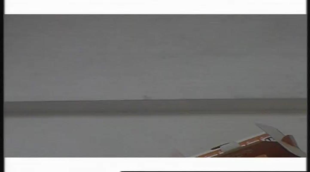

  • Hi,all
    I met the same program,but my white line at bottom is very thick,while i adjust     upper_margin =0x2c, in a measure  of the white  line go top,
    .upper_margin =0x2c,
    .lower_margin=0,         no matter what adjust,the white bar go up and lower,but  total area no reduce,the vpbe bug what about ravel out ? thanks.

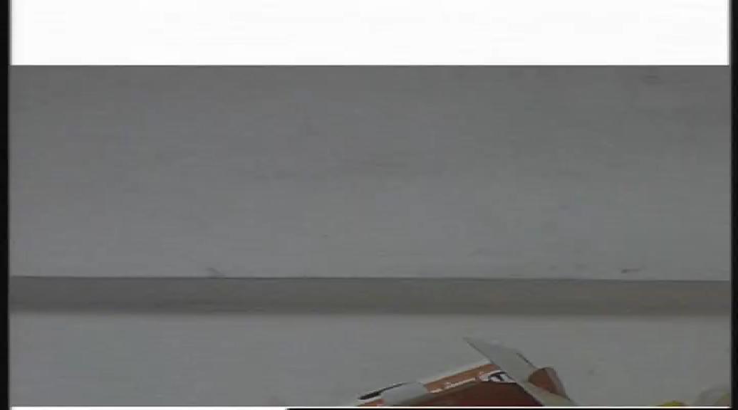

  • this is other experiment,
    .upper_margin =0x42,
    .lower_margin=0x42,
