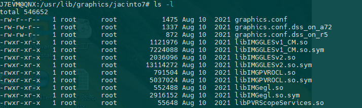

    My environment variables are as follows
    File properties are as follows
    Please run a "pidin ar", and take a look at the path that screen is referencing for the graphics.conf:
    screen -c /ti_fs/usr/lib/graphics/jacinto7/graphics.conf.dss_on_r5
    If the -c option is not used then Screen would check for the GRAPHICS_ROOT env variable.
    When screen is launched, it will use environment variables present at the time it is launched, to determine library search path.  If launched from the BSP startup script, it would use the env variables from there (see build file).  If launched from local script, it may use env variables specified there.  If launched from command line it would use the local environment variables.
    Note that environment variables that are set within the shell script, do not persist back to command line.
    For testing, recommend you "slay screen", set your local environment variables , and then launch screen, to ensure you know what env variables are being used.  The /ti_fs/scripts/user__dss_on_a72.sh can be referenced for setting of variables.  Instead of running the script, copy and paste on command line.
