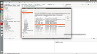

While building the code i was getting error in the file of csl_epwm.h.I have observed that location of csl_epwm.h is at C:\ti\AM5749\pdk_am57xx_1_0_17\packages\ti\csl. and its source file csl_epwm.c location is at C:\ti\AM5749\pdk_am57xx_1_0_17\packages\ti\csl\src\ip\epwm\V0\priv .
At that time i was getting error as an undefined function for all csl function like CSL_epwmTbTimebaseClkCfg
Then i have shifted these files
csl_epwm.c
csl_epwm.h
cslr_epwm.h
hw_pwmss_epwm.h
hw_pwmss_submodule_offsets.h
to Project\Include
After that it is giving me error in the HW_WR_FIELD16 as per the attached image
I have following query
1) Does the directory of csl_epwm.h is correct, at C:\ti\AM5749\pdk_am57xx_1_0_17\packages\ti\csl.
2) Whatever method i am following is correct?
3) How to configure ePWM for AM5749 processor?
Thanks & Regards,
Divyesh Patel
    Yes, it is fine.
    Instead of directly writing by taking reference, you can try the CSL example first at  ~\pdk_am57xx_1_0_17\packages\ti\csl\example\epwm\epwm_duty_cycle_test_app.
    you can follow below threads for the reference:
  • Hi Sir,
    Thank you for your feedback.

    One more doubts i have that when i was following the example of GPIO LED Blink, in the section of GNU Compiler->Directories
    these path were set by flag and in the Resources->Linked Resources
    directory of those flags were defined.
    But the name of the flag used in "GNU Compiler->Directories" is not matching with the "Resources->Linked Resources" .

    Sorry, but this is something that you have to try it yourself as already mentioned it is not recommended.
    But, this is possible. See the attached zipped project where i created GPIO led example from scratch.gpio_ledBlink.zip

    Can you please share the steps, how you linked the required files?
    Thanks & Regards,
    Divyesh Patel
    There are no steps as such, the only thing i did was i compare myProject property and sdkProject property tab by tab and tried to replicate. We can't generalized this more than what is present in CCS documentation.  That's why, we don't recommend to write from scratch.
