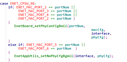

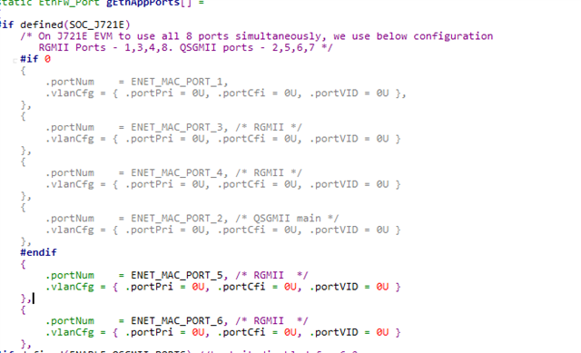

         Now, I follow the FAQ to modify the code. But I can't ping the TC397 from the A72. The attachment is the detailed log.
         Please note that there have no any PHY connect to CPSW9G

    the schematic:
    the code:
    enet_appboardutils_j721e_evm.c:
    gEthAppPorts:
