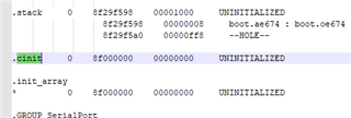

So far we have used the compiler version 7.3.4 of the DSP, we have changed version
to 7.6.0 this resulted in one of the blocks instead of having zero at the last word location,
we are having the data of 0xA9690000 at that location, the data can varies.
The location is always at the last word in the block.
When loading the same file to the DSP using jtag we are having no problem
So it seems that the problem is on the driver syslink
Also the file size of the out file reduced in 40% relative to the older version.

  • Hi Doron,
    Any reasons for picking/using 7.6.0 CGT? I do not see this release on the public Code Generation Tools Downloads page, I only see 7.3.x and 7.4.x in the 7.x release stream, which have more stable releases done later than the 7.6.x release. The various components in the stack - SYS/BIOS, XDC, IPC, SysLink releases are only cross-verified against some known compilers. I do not see any product using a 7.6.x CGT.
    What image format are you using? If you are using ELF, can you give the output of "readelf -l" command on both the versions and which address is getting affected from your ELF files?
    Can you provide some more clarifications on this?
    - Is it only on one of the blocks or is it on all blocks?
    - Is the last word part of the ELF loadable section area (address is part of FileSiz and not MemSiz from readelf -l output)?
    ProcMgr only loads the contents that have a positive FileSiz and zero initializes any memory that is > FileSiz and < MemSiz. If your address falls into this area, then that section is expected to be initialized by the C Runtime code on the firmware-side. So, please look through your map files and compare the TI_CInit tables. The C Runtime initialization logic comes from the Compiler.

  • "What image format are you using? If you are using ELF, can you give the output of "readelf -l" command on both the versions and which address is getting affected from your ELF files?"
    - we are using elf format
    - attached file are the readelf file requested
    - the affected address is 0x8F293A20 the start address of the block is 0x8F291AE0    and the bloack size is 8000 bytes (2000 32bit size)
    "- Is it only on one of the blocks or is it on all blocks?"
    • One block
    "is the last word part of the ELF loadable section area"
            the last word is part of the elf file
    "ProcMgr only loads the contents that have a positive FileSiz and zero initializes any memory that is > FileSiz and < MemSiz. If your address falls into this area, then that section is expected to be initialized by the C Runtime code on the firmware-side. So, please look through your map files and compare the TI_CInit tables. The C Runtime initialization logic comes from the Compiler."

  • Hi Suman
    we do not have the TI_Cint_Tables in the map file
    at that area please see the picture
    Doron Gabbay

  • This is what we have
  • Hi Doron,
    Interesting, and does this look the same with 7.3.4 as well?
    regards
    Suman
