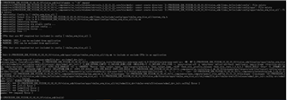

I follow vision sdk TDA3XXX uerguide section 3.2 building the application, sdk verison is 03-08-00-00,
There are some errors when run gmake command: gmake -s -j depend or gmake -s "-j6" depend or gmake -s depend.
Please help to slove this issue,thanks!
  • Hello
    Add build.log for you reference.

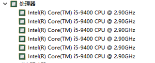

    PS:  my pc is win10 64 bit  ,intel 6 Core Processor.
    I only modfiy PROCESSOR_SDK_VISION_03_08_00_00\vision_sdk\build\Rules.make
    MAKECONFIG?=tda3xx_evm_bios_all, i don't know why these errors occered.

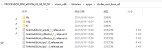

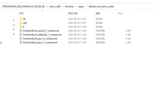

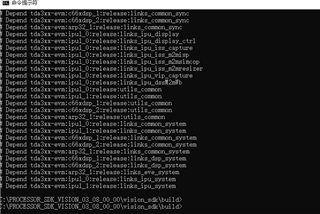

    We build PROCESSOR_SDK_RADAR_03_08_00_00, run gmake -s depend ,On a build completion, the executables not be generated in the below path C:\PROCESSOR_SDK_RADAR_03_08_00_00\vision_sdk\binaries\apps\tda3xx_evm_bios_radar/
    Attached is build log,please check it.thanks.
    C:\Users\brx>cd /
    C:\>cd C:\PROCESSOR_SDK_RADAR_03_08_00_00\vision_sdk\build
    C:\PROCESSOR_SDK_RADAR_03_08_00_00\vision_sdk\build>gmake -s depend

    # Depend tda3xx-evm:ipu1_0:release:links_common_algorithm
    # Depend tda3xx-evm:ipu1_1:release:links_common_algorithm
    # Depend tda3xx-evm:c66xdsp_1:release:links_common_algorithm
    # Depend tda3xx-evm:arp32_1:release:links_common_algorithm
    # Depend tda3xx-evm:ipu1_0:release:links_common_dup
    # Depend tda3xx-evm:ipu1_1:release:links_common_dup
    # Depend tda3xx-evm:c66xdsp_1:release:links_common_dup
    # Depend tda3xx-evm:arp32_1:release:links_common_dup
    # Depend tda3xx-evm:ipu1_0:release:links_common_gate
    # Depend tda3xx-evm:ipu1_1:release:links_common_gate
    # Depend tda3xx-evm:c66xdsp_1:release:links_common_gate
    # Depend tda3xx-evm:arp32_1:release:links_common_gate
    # Depend tda3xx-evm:ipu1_0:release:links_common_ipcIn
    # Depend tda3xx-evm:ipu1_1:release:links_common_ipcIn
    # Depend tda3xx-evm:c66xdsp_1:release:links_common_ipcIn
    # Depend tda3xx-evm:arp32_1:release:links_common_ipcIn
    # Depend tda3xx-evm:ipu1_0:release:links_common_ipcOut
    # Depend tda3xx-evm:ipu1_1:release:links_common_ipcOut
    # Depend tda3xx-evm:c66xdsp_1:release:links_common_ipcOut
    # Depend tda3xx-evm:arp32_1:release:links_common_ipcOut
    # Depend tda3xx-evm:ipu1_0:release:links_common_merge
    # Depend tda3xx-evm:ipu1_1:release:links_common_merge
    # Depend tda3xx-evm:c66xdsp_1:release:links_common_merge
    # Depend tda3xx-evm:arp32_1:release:links_common_merge
    # Depend tda3xx-evm:ipu1_0:release:links_common_null
    # Depend tda3xx-evm:ipu1_1:release:links_common_null
    # Depend tda3xx-evm:c66xdsp_1:release:links_common_null
    # Depend tda3xx-evm:arp32_1:release:links_common_null
    # Depend tda3xx-evm:ipu1_0:release:links_common_network_tx
    # Depend tda3xx-evm:ipu1_1:release:links_common_network_tx
    # Depend tda3xx-evm:c66xdsp_1:release:links_common_network_tx
    # Depend tda3xx-evm:arp32_1:release:links_common_network_tx
    # Depend tda3xx-evm:ipu1_0:release:links_common_network_rx
    # Depend tda3xx-evm:ipu1_1:release:links_common_network_rx
    # Depend tda3xx-evm:ipu1_0:release:links_common_nullSrc
    # Depend tda3xx-evm:ipu1_1:release:links_common_nullSrc
    # Depend tda3xx-evm:ipu1_0:release:links_common_select
    # Depend tda3xx-evm:ipu1_1:release:links_common_select
    # Depend tda3xx-evm:c66xdsp_1:release:links_common_select
    # Depend tda3xx-evm:arp32_1:release:links_common_select
    # Depend tda3xx-evm:ipu1_0:release:links_common_sync
    # Depend tda3xx-evm:ipu1_1:release:links_common_sync
    # Depend tda3xx-evm:c66xdsp_1:release:links_common_sync
    # Depend tda3xx-evm:arp32_1:release:links_common_sync
    # Depend tda3xx-evm:ipu1_0:release:links_ipu_display
    # Depend tda3xx-evm:ipu1_0:release:links_ipu_display_ctrl
    # Depend tda3xx-evm:ipu1_0:release:links_ipu_iss_capture
    # Depend tda3xx-evm:ipu1_0:release:links_ipu_vip_capture
    # Depend tda3xx-evm:ipu1_0:release:links_ipu_dssM2mWb
    # Depend tda3xx-evm:ipu1_0:release:utils_common
    # Depend tda3xx-evm:ipu1_1:release:utils_common
    # Depend tda3xx-evm:c66xdsp_1:release:utils_common
    # Depend tda3xx-evm:arp32_1:release:utils_common
    # Depend tda3xx-evm:ipu1_0:release:links_common_system
    # Depend tda3xx-evm:ipu1_1:release:links_common_system
    # Depend tda3xx-evm:c66xdsp_1:release:links_common_system
    # Depend tda3xx-evm:arp32_1:release:links_common_system
    # Depend tda3xx-evm:c66xdsp_1:release:links_dsp_system
    # Depend tda3xx-evm:arp32_1:release:links_eve_system
    # Depend tda3xx-evm:ipu1_0:release:links_ipu_system
    # Depend tda3xx-evm:ipu1_1:release:links_ipu_system

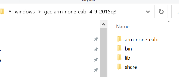

    Before build  PROCESSOR_SDK_RADAR_03_08_00_00 , we have installed gcc-arm tool chain.
    Do we need to install GCC gcc-arm tool under C:\PROCESSOR_SDK_RADAR_03_08_00_00\ti_components\cg_tools\windows/   &
    C:\PROCESSOR_SDK_VISION_03_08_00_00\ti_components\cg_tools\windows/?
    After re-installing the ARM-gcc tool, no executable program was generated  .
  • did you just run "make depend"? This will just build dependencies. After this command, can you run "make sdk"?
    Brijesh
  • Hello
    Run :  make -s depend
  • Please go through the build and run section of the TDA3xx userguide, vision_sdk\docs\UserGuides\VisionSDK_UserGuide_TDA3xx.pdf.
  • Hello Brijesh
    I follow build and run section of the TDA3xx userguide, run gmake command: gmake -s -j depend or gmake -s depend.
    I don't know what the problem is, the executable won't be generated.
    PS:  my computer has a single CPU, 6 core.
  • After building dependencies using "make -s -j depend", can you run "make -s -j4"? This will build binaries, which can be loaded on the cores.

    First i run : gmake -s depend then run gmake -s ,the binary files have been generated.
    Because my pc is single cpu, i didn't add the -j option.
    is that correct or not?
  • Yes, that's correct.
  • Please make sure your GCC ARM compiler is install at the following location with the exact name. You should have folders like shown in the below image.
    ~\ti_components\cg_tools\windows\gcc-arm-none-eabi-4_9-2015q3
