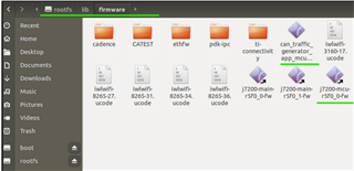

We tried to use the SD card to boot the can_traffic_generator demo code (mcu1_0) of the CAN-Ethernet Gateway demo, but the program seemed to not start,
and when we updated the can_traffic_generator demo code (mcu1_0) using OSPI, The program started successfully.
About the SD card booting, We have copied the files to the SD card and have executed the software link command.
Also, changed the boot switch to SD card boot mode.
Could you please help ?
Please refer to the picture below in SD card.

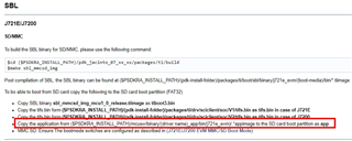

  • Hi Vineet
    We check again the MCUSW User Guide for SD Boot as following, it seams need put MCU1_0 image into SD card boot partition not rootfs partition
    we will try it , thanks
    BR
    JAY
  • Hi Jay,
    MCUSW applications are SBL bootflow only, so, no rootfs.
    Vineet

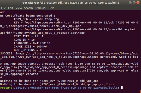

    We run the step to SBL bootflow as following

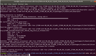

    (1)To build the SBL binary for SD/MMC, please use the following command:
    make sbl_mmcsd_img BOARD=j7200_evm SOC=j7200
    (2) copy the following to the SD card boot partition (FAT32)
    -Copy SBL binary sbl_mmcsd_img_mcu1_0_release.tiimage as tiboot3.bin
    cp /opt/ti-processor-sdk-rtos-j7200-evm-08_00_00_12/pdk_j7200_08_00_00_37/packages/ti/boot/sbl/binary/j7200_evm/mmcsd/bin/sbl_mmcsd_img_mcu1_0_release.tiimage /media/js/boot/
    mv /media/js/boot/sbl_mmcsd_img_mcu1_0_release.tiimage /media/js/boot/tiboot3.bin
    -Copy the tifs.bin form ($PSDKRA_INSTALL_PATH)/(pdk-install-folder)/packages/ti/drv/sciclient/soc/V2/tifs.bin as tifs.bin in case of J7200
    cp /opt/ti-processor-sdk-rtos-j7200-evm-08_00_00_12/pdk_j7200_08_00_00_37/packages/ti/drv/sciclient/soc/V2/tifs.bin /media/js/boot/
    -we build MCUSW image as following,
    then copy the application from ($PSDKRA_INSTALL_PATH)/mcusw/binary/(driver name)_app/bin/j721e_evm)/.*appimage to the SD card boot partition as app
    make -s all BOARD=j7200_evm SOC=j7200
    cp /opt/ti-processor-sdk-rtos-j7200-evm-08_00_00_12/mcusw/binary/adc_app/bin/j7200_evm/adc_app_mcu1_0_release.appimage  /media/js/boot/

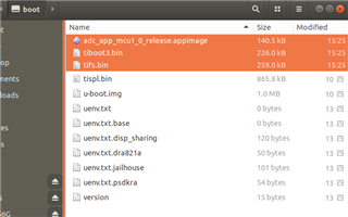

    (3) SD CARD boot partition as following:

    (5) Then , we use SD CARD boot , MCU UART message shows: SD Boot - File open fails
    SBL Revision: 01.00.10.01 (Aug 23 2021 - 12:32:23)
    TIFS  ver: 21.5.0--v2021.05 (Terrific Llam
    please help to fix SD CARD boot flow.
    BR
    JAY
  • Hi Jay,
    You need to rename the application to "app" on SD card
    Vineet
  • Hi Vinnet
    Thanks your information.
    We finally can boot MCU1_0 from SD CARD boot, but linux(a72/main r5f) still not boot at the same time
