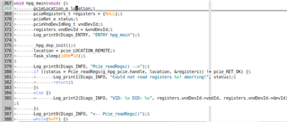

However now I have another problem after trying to read VID/DID register:

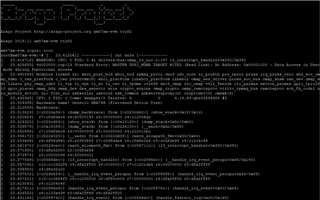

VID and DID are equal to 0. In the same time linux generates below error:

    The L3 error was triggered from DSP read access to PCIE2.
    This L3 error typically happens if PCIE2 was not clocked when DSP tried to access it.
    I assume PCIE2 is enabled in Linux Kernel so maybe DSP tries to access it before it is enabled during Linux kernel boot.
    Stanley
    I have tried to add 10 second delay in DSP code during linux booting, before DSP make any access to PCIe however it does not change anything. Same error
    44000000.ocp:L3 Standard Error: MASTER DSP1_MDMA TARGET PCIE2 (Read Link): At Address: 0x00001000 : Data Access in User mode during Functional access
    still occures.

    We fixed 44000000.ocp:L3 Standard Error: MASTER DSP1_MDMA TARGET PCIE2 (Read Link): At Address: 0x00001000 : Data Access in User mode during Functional access error, but now we are facing another problem.
    When we call this method (from TI example for AM57X):
    statusCmd.ioSp = 1;
    statusCmd.memSp = 1;
    statusCmd.resp = 1;
    setRegs.statusCmd = &statusCmd;
    if ((status = Pcie_writeRegs(conf.handle, location, &setRegs)) != pcie_RET_OK) {
        Console_printf("Could not write register!");
    On FPGA we are receiving cyclic RX data with random data and on A15 below error occurs:
    omap_l3_noc 44000000.ocp: L3 application error: target 5 mod:1 (unclearable)
    omap_l3_noc 44000000.ocp: L3 debug error: target 5 mod:1 (unclearable)
    What can be a reason of this L3 errors.

    root@am57xx-evm:~# devmem2 0x20400000 w 0xdeadbeef
    /dev/mem opened.
    [ 1114.225490] [EXIT] init_hpg:533
    [ 1126.200007] omap_l3_noc 44000000.ocp: L3 application error: target 5 mod:1 (unclearable)
    Memory mapped at address 0xb6f9d000.
    Read at address 0x2040000[ 1126.211460] omap_l3_noc 44000000.ocp: L3 debug error: target 5 mod:1 (unclearable)
    0 (0xb6f9d000): 0xFFFFFFFF
    Write at address 0x20400000 (0xb6f9d000): 0xDEADBEEF, readback 0xDEADBEEF
    root@am57xx-evm:~# devmem2 0x20400000 w 0xdeadbabe
    /dev/mem opened.
    Memory mapped at address 0xb6f63000.
    Read at address 0x20400000 (0xb6f63000): 0xFFFFFFFF
    Write at address 0x20400000 (0xb6f63000): 0xDEADBABE, readback 0xDEADBABE
    triger on vivado: visible
    What is interested in last case: we do not getting L3 application error when we try to transmit data directly from driver to FPGA.
    BR,
    M.

    Sorry to circle back to your original problem. I thought you mentioned:
    >>After confirmation of working A15 <-PCIe-> FGPA communication, we have decided to change our design and allow only DSP to communicate with FPGA. So now A15 Linux only knows about connected FPGA but do not touch it and does not load any driver to communicate with it.
    So I assume your first method of letting Linux driver to enumerate the PCIe driver space, then let DSP to read/write to the space was working, but then you want to switch to DSP-side of baremetal driver completely. Is this the correct understanding?
    If so, I don't believe the DSP driver code has the probing function like Linux driver does, where it detects the memory space the FPGA offered. The function Pcie_getMemSpaceRange() does not return the probed FPGA windows. instead, you need to add code to write then read back the remote BAR MASK registers, then calculate the memory space, then enable the remote memory region by writing to the the command register of the PCIe structure. some pseudo code to enable memory region like below:
                   get_epval = *((volatile uint32_t *) (uintptr_t)(PCIE_WINDOW_CFG_BASE+0x0004U));
                   put_val = get_epval | 0x02U ;  // Enable memory space
                  *((volatile uint32_t *) (uintptr_t)(PCIE_WINDOW_CFG_BASE+0x0004U)) = put_val;
                  PCIE_logPrintf ("     RC set CMD_STS: wrote 0x%08X, readback 0x%08X\n", put_val, get_epval);
    regards
    Jian

    But now we are trying to run EDMA and transmit data, we are receiving error:
    [ 21.718957] omap_l3_noc 44000000.ocp: L3 application error: target 5 mod:1 (unclearable)
    [ 21.727117] omap_l3_noc 44000000.ocp: L3 debug error: target 5 mod:1 (unclearable)
    During debugging(Code Compose Studio), we found that error occurs when we are trying to save data into ESR register, in method EDMA3_DRV_enableTransfer, file edma3_drv_basic.c, line 1924. It look that we don't have access to such region.
    Shall we add some memory regions to DSP resource table? If yes, then which are proper? Because we are trying to use regions below:
    And still we have such error.
    From the other hand, before we started adding memory regions into DSP resource table, we had an error:
    21.580621] omap-iommu 40d02000.mmu: iommu fault: da 0x401d1400 flags 0x0
    [ 21.587443] remoteproc remoteproc2: crash detected in 40800000.dsp: type mmufault
    [ 21.594963] omap-iommu 40d02000.mmu: 40d02000.mmu: errs:0x00000002 da:0x401d1400 pgd:0xfef2897d *pgd:px00000000
    [ 21.606636] remoteproc remoteproc2: handling crash #1 in 40800000.dsp
    [ 21.613319] remoteproc remoteproc2: recovering 40800000.dsp
    [ 21.625577] remoteproc remoteproc2: stopped remote processor 40800000.dsp
    [ 21.634515] remoteproc remoteproc2: powering up 40800000.dsp
    [ 21.647981] remoteproc remoteproc2: Booting fw image dra7-dsp1-fw.xe66, size 5287160
    [ 21.655962] omap-iommu 40d01000.mmu: 40d01000.mmu: version 3.0
    [ 21.661845] omap-iommu 40d02000.mmu: 40d02000.mmu: version 3.0
    [ 21.680122] virtio_rpmsg_bus virtio0: rpmsg host is online
    [ 21.690571] remoteproc remoteproc2: registered virtio0 (type 7)
    [ 21.698727] remoteproc remoteproc2: remote processor 40800000.dsp is now up
    Caught in the same line in EDMA3_DRV_enableTransfer, in file edma3_drv_basic.c, line 1924.
    Thanks in advance Jian :)
