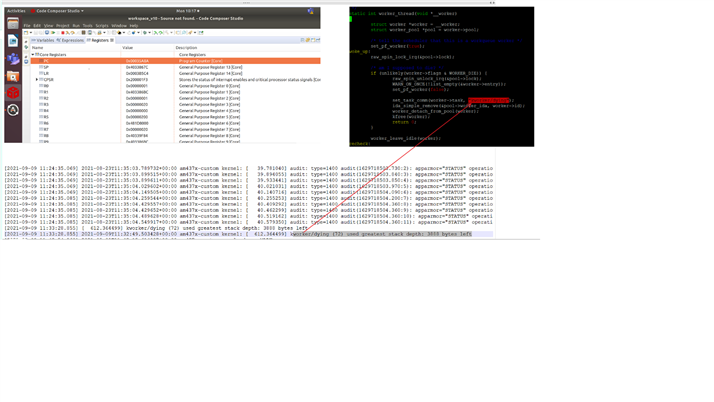

    We switched to ti-rt-39 kernel and started running our tests again. So far 3 times we have seen hang.
    We used CCS to find the program counter values and attached is the finding.
    We would need your assistance to find why this is happening.
       vmlinux-rt39-dump - Copy.zip
  • Data from one more hang is attached here
    ti-rt-39-hang-3-sep-2021.pdf

  • Hi Team,
    The test is in progress with TI recommended kernel,  ti-rt-39.
    Adding few more debug and Logs information.
    There were two tests run:
    on sep-9 with CAN validation in place ---Kernel hang is observed
    on Sep-13 with our CAN validation and only GPIO toggle. --- Kernel Crash is observed.
    Kernel Hang issue:
    Kernel Crash:
     Sep13-logs.zip
    Attached are the logs for these two observations.
  • Hi Annapurna,
    Thanks for the updates. The new crash logs from the TI SDK kernel seem to be different from the original one you provided in the first post. The original crash seems happening in the CAN driver related code, but the latest crash is in kernel workqueue processing. Not sure if both crashes are caused by the same reason.
    I also received the script to run the GPIO/ADC test from offline emails. I have it running on my AM437x GPEVM with a slight modification (added steps to enable the GPIOs and disabled a few which are not available in the SDK v6.3 prebuilt kernel), hopefully I can see the same crash tomorrow morning. I will keep you posted on the test result.
