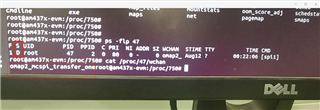

I use the SPI bus to connect to other devices, SPI for host mode,Tx and Rx both Use DMA mode.
I find that the SPI thread state becomes D when running for some time.
the SPI thread PID is 47
cat /proc/47/wchan  ,return  show :omap2_mcspi_tranfer_one
then i find omap2_mcspi_txrx_dma() use completion,and set it to TASK_UNINTERRUPTIBLE,
when i use kernel 4.19.94(last SDK),Without this issue.

    Call relationship:omap2_mcspi_transfer_one()->omap2_mcspi_txrx_dma()->mcspi_wait_for_completion(),Maybe there's something wrong with this place,It can make the thread TASK_UNINTERRUPTIBLE.I guess.
    The problem is contingency,Sometimes it comes quickly, sometimes it takes a long time.But the probability of occurrence is quite high.
