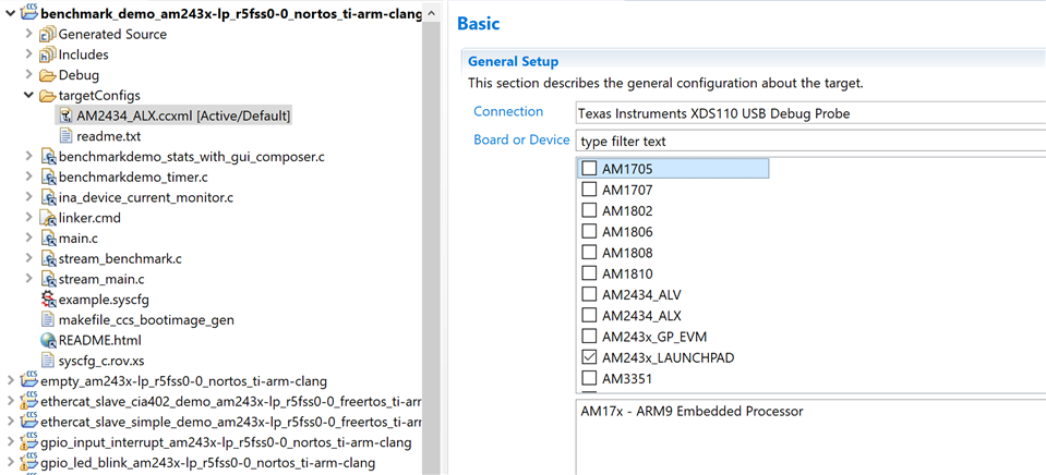

Hi Dhaval, I have previously set up the board using the 8.0 SDK. However, if I try to debug PRU code, I get an error: ICSS_G0_PRU_0: GEL: Target must be connected before calling the function. If I try to connect whilst debugging an R5F core (image below) I can get the PRU into a 'connecting: in reset' mode but, if I try to load a file, I get the same error.
Any ideas?
Steve

Still not working - but a clue:?
Someone suggested I run the load_dmsc.js script.
This happened first:
js:> loadJSFile "C:\ti\mcu_plus_sdk_AM243x_08_01_00_07\tools\ccs_load\am64x_AM243x\load_dmsc.js"
Could not start server: DebugServer.1: Cannot read System Setup data from XML file C:\Users\xxxxxxxx\workspace_v10\benchmark_demo_am243x-lp_r5fss0-0_nortos_ti-arm-clang\targetConfigs\AM2434_ALX.ccxml
Error parsing file:
Fatal Error at (0, 0): An exception occurred! Type:RuntimeException, Message:The primary document entity could not be opened. Id=C:\Users\xxxxxxxx\workspace_v10\benchmark_demo_am243x-lp_r5fss0-0_nortos_ti-arm-clang\targetConfigs\AM2434_ALX.ccxml (C:\ti\mcu_plus_sdk_AM243x_08_01_00_07\tools\ccs_load\am64x_AM243x\load_dmsc.js#134)
js:>
So I then imported the demo project but got this error:
Connecting to DMSC_Cortex_M3_0!
[ERROR] GEL files are not loaded to Cortex-M3 !!! Please choose the right target configuration or load GELs manually from C:\ti\ccs1040\ccs\ccs_base\emulation\gel\AM64x\AM64x.gel and try again...
js:>
However, the debugging console started and I was able to connect to the R5 but still no luck with the PRU:
I suspect it's something trivial but, when you don't know, you really don't know.
Steve
Progress. The debug probe settings in the demo project was set to AM2434_ALX. Setting it to Launchpad means I can now attach to the PRU using the load_dmsc script.

Specifically, it looks like the default configuration suggests bypassing the ICSSGs (which you do NOT want to do if you are developing on PRU).
Nick
Yes, I noticed that in the setup instructions - all configurations I was using do not have the PRU bypassed though.
Steve

I'm now in 'no boot' mode - this has helped and I'm now able to step through some code. I'm not sure which of the 20 steps I took was the key so I'm working backwards to the point where it no longer works.
FYI, the Hello World PRU example fails with an out of memory error but simple loops appear to work. Need to understand how the .text area is mapped.
