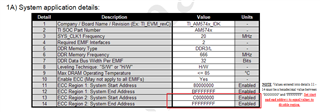

I have a TMDSIDK574 AM5749 board and would like to know about the DDR3 setup.
EMIF_RegisterConfig.xlsm (www.ti.com/.../sprac36)
was used to compare with the TMDSIDK574 set value.
EMIF_RegisterConfig
AM57x, DRA7x, and TDA2x Corrected items 13 and 14 according to the EMIF Tools guide.
The u-boot source used is the latest version of ti-processor-sdk-linux-am57xx-evm-06.03.00.106.
1. the values in the Register values (U-Boot) tab are different from the u-boot source contents. I want to know the reason.

2. Please provide a detailed description of the field data.
Reference schematic
AM574x Industrial Development Kit (IDK) Schematic — SPRR351.ZIP
2A) Signal CLK field stripline value is the schematic pin (Proj PROC053 001 OPN# TMDSIDK574)
Byte 0 : AM5749ABZXEA DDR1_CK - U5 DDR_CLK
ECC : U7 DDR_CLK - U6 DDR_CLK
Is the connection correct? What pins are byte1 ~ byte3 connected to? Please provide a detailed explanation.
2A) Signal DQSn field stripline value is the schematic pin (Proj PROC053 001 OPN# TMDSIDK574)
Byte 0 : AM5749ABZXEA DDR1_DQS0n - U5 DDR_DQSn0
ECC : AM5749ABZXEA DDRECC_DQSn- U6 DDRECC_DQSn
2C) The EMIF2 field cannot be fully filled with pin connection. Please explain in detail which value is correct.
Please help me to understand.
