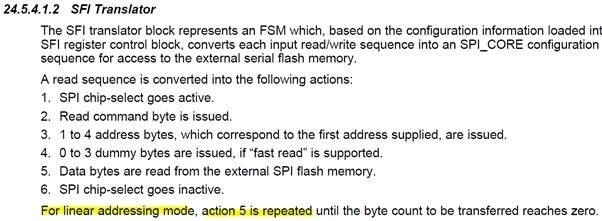

  • Hi Anubhav,
    My intention is not control CS active state but to implement burst mode and send bunch of data bytes(action 5 repeated) after address/dummy bytes as described in TRM as below.
    When my customer captured each signals in the QSPI, they found additional 16 CLK and 8 CLK (Red Box) at each data byte(Blue Box) as below. They want to remove these 'Red Boxes' except 1st one and to know why these red box occurred continuously.
    They modified only few things from basic exampled of pdk , and used linear addressing mode as below.
    Thanks and Best Regards,
    SI.
