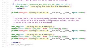

   I do the test on my platform , psdkla version is sdk7.2 , platform is our customer board,
1, set dorprocboot=0 in uboot,  linux blocked at "remoteproc remoteproc4: Booting fw image j7-main-r5f0_1-fw"
2. set dorprocboot=1 in uboot,  linux work fine.
   About the block problem, I add some log for simple test, it seems that the system was blocked at below code in funciton k3_r5_rproc_prepare
memset(core->mem[0].cpu_addr, 0x00, core->mem[0].size);
please check the picture attached.

source code picture:
 After compare the logs between good and no good, the difference as below, I hope it is useful.
and I attach the log to the case
ipc_only_mode_work.log    :  boot up ok
remoteproc_mode_fail.log : boot up failed

[2021-08-19 16:23:42.757] [    3.258858] hjwang rproc_boot-2110:5d00000.r5f 0
[2021-08-19 16:23:42.803] [    3.263490] remoteproc remoteproc4: powering up 5d00000.r5f
[2021-08-19 16:23:42.803] [    3.269910] remoteproc remoteproc4: Booting fw image j7-main-r5f0_1-fw, size 1923072
[2021-08-19 16:23:42.804] [    3.277664] hjwang rproc_fw_boot-1663:5d00000.r5f
[2021-08-19 16:23:42.804] [    3.282753] hjwang rproc_fw_boot-1665:5d00000.r5f ret=0
[2021-08-19 16:23:42.804] [    3.288107] hjwang k3_r5_rproc_prepare-396:5d00000.r5f
[2021-08-19 16:23:42.804] [    3.293588] hjwang k3_r5_rproc_prepare-399:5d00000.r5f
[2021-08-19 16:23:42.805] [    3.299141] hjwang k3_r5_rproc_prepare-407:5d00000.r5f
[2021-08-19 16:23:42.805] [    3.304369] hjwang k3_r5_rproc_prepare-413:5d00000.r5f
[2021-08-19 16:23:42.824] [    3.309590] hjwang k3_r5_rproc_prepare-425:5d00000.r5f
  • The difference between about the two log as below,  I can't find the log in the failed case .
