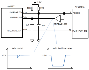

I have an AM437x based design, the PMIC is the tps65218d0.
Everything works, the only problem is with the command linux: sudo reboot, the system shuts down.
Do you have any idea why this happens?
Where can I find information about the relationship between the linux command and the impact on the hardware?

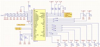

Attached is the schematic related to the TPS. The design is very similar to the EVM, only the PB and AC_DET pins change. Could this be the problem?
