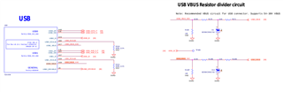

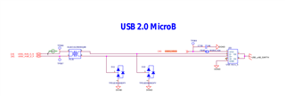

Hi, I want to use usb1 as a peripheral mode. so i can run "ums 1 mmc 1" in uboot ,make the board as a device.
when i change the "k3-j721e-common-proc-board.dts" as below:
&usbss1 {
	pinctrl-names = "default";
	pinctrl-0 = <&main_usbss1_pins_default>;
	ti,usb2-only;
&usb1 {
	dr_mode = "peripheral";
	maximum-speed = "high-speed";
and the uboot brinup log is :

=> ums 1 mmc 1
UMS: LUN 0, dev 1, hwpart 0, sector 0x0, count 0x1dacc00
Unable to get USB2 phy (ret -22)
Unable to get USB3 phy (ret -61)
DRD version v1 (ID: 0004024e, rev: 00000200)

dev_get_priv: null device
Is there anything else i neet to change ?
