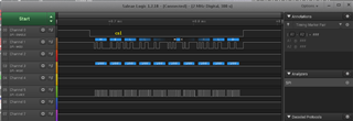

  • Hi,  Keerthy
    SPI3 device node with CS1 appears.
    spidev 3.0 works fine, but spidev 3.1 doesn't work, because I do not capture any physical signal from spidev3.1
    1. DT Modify as below:
    	main_spi3: spi@2130000 {
    		compatible = "ti,am654-mcspi","ti,omap4-mcspi";
    		reg = <0x0 0x2130000 0x0 0x400>;
    		interrupts = <GIC_SPI 187 IRQ_TYPE_LEVEL_HIGH>;
    		clocks = <&k3_clks 269 1>;
    		power-domains = <&k3_pds 269 TI_SCI_PD_EXCLUSIVE>;
    		ti,spi-num-cs = <2>;
    		#address-cells = <1>;
    		#size-cells = <0>;
    2. check spidev node, it's fine
    root@j7-evm:~# ls /dev/ | grep spidev
    spidev3.0
    spidev3.1
    3. write data to spi 3.0 and physical signal capture
    root@j7-evm:~# ./spidev_test -v -D /dev/spidev3.0 -p "HELLOWORLD"
    spi mode: 0x0
    bits per word: 8
    max speed: 500000 Hz (500 KHz)
    TX | 48 45 4C 4C 4F 57 4F 52 4C 44 __ __ __ __ __ __ __ __ __ __ __ __ __ __ __ __ __ __ __ __ __ __  |HELLOWORLD|
    RX | 00 00 00 00 00 00 00 00 00 00 __ __ __ __ __ __ __ __ __ __ __ __ __ __ __ __ __ __ __ __ __ __  |..........|
    if I .set  /spidev_test -v -D /dev/spidev3.1 -p "HELLOWORLD", No signal out.
    Do I miss something?

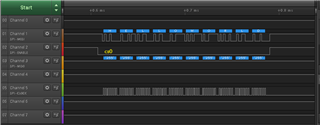

  • Today update,
    I wrote a simple SPI read program to test  "/dev/spidev3.1"
    cs1 --> no action
    miso -> have signal, correct
    mosi -> have signal, corrett
    clk -> yes!

    the problem is why chip select 1 do not work?
    Any Comment?
    Many Thanks
  • Gibbs,
    If I follow it correctly, MISO/MOSI/CLK are all good but CS is not changing.
    Can you double check the CS1 pad configuration is correct as per your custom board?
    Sorry I cannot reproduce as i do not have the board.
    - Keerthy
  • Keerthy ,
    You are right!
    Our HW make a mistake,  CS1 & MOSI are short.
    The scope shows correct work after HW re-work
    Many Thanks
    Gibbs
