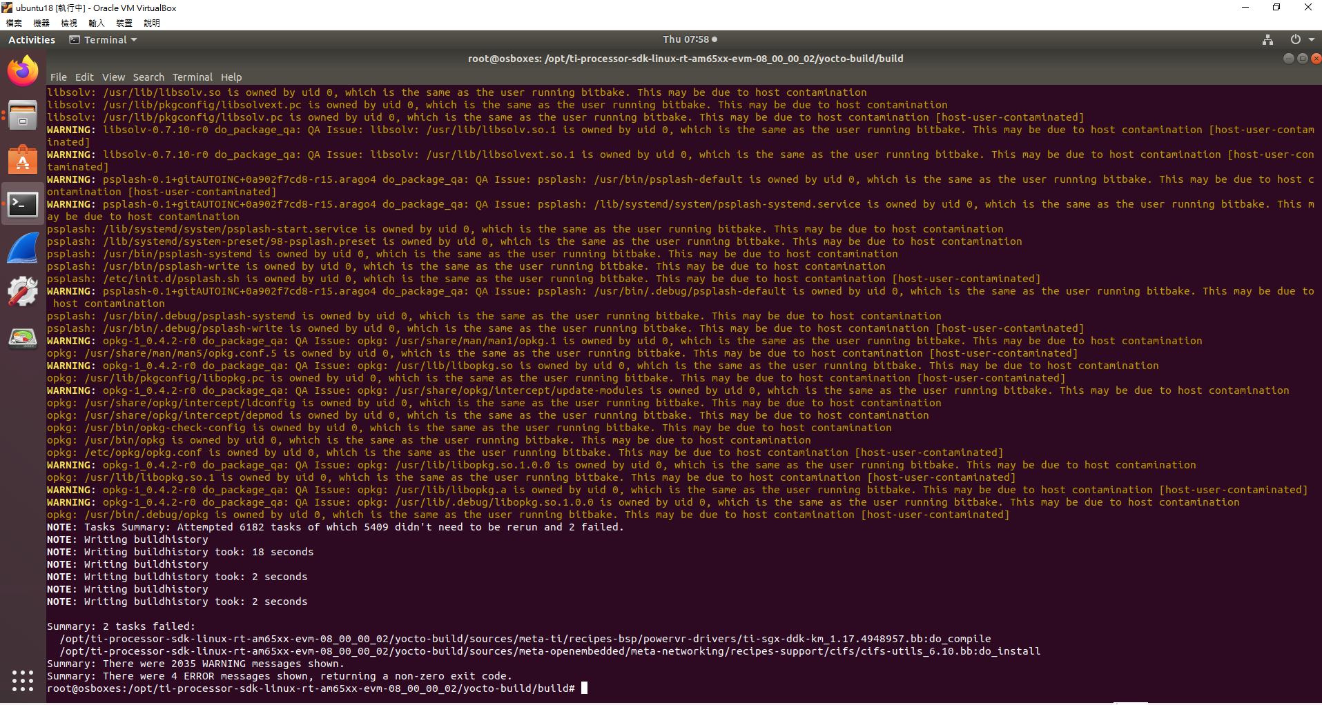

AM6548: yocto build base filesystem error in PSDK 8.0
Part Number: AM6548
Dear TI
I have installed PSDK LINUX8.0 and download ti  yocto recipe
Following command can build filesystem by yocto successfully,and get image file in deploy directory
MACHINE=am65xx-evm bitbake -k tisdk-tiny-image
Following command will build failed,and show Error components is cifs-utils
MACHINE=am65xx-evm bitbake -k tisdk-base-image
Summary: 2 tasks failed:
/opt/ti-processor-sdk-linux-rt-am65xx-evm-08_00_00_02/yocto-build/sources/meta-ti/recipes-bsp/powervr-drivers/ti-sgx-ddk-km_1.17.4948957.bb:do_compile
/opt/ti-processor-sdk-linux-rt-am65xx-evm-08_00_00_02/yocto-build/sources/meta-openembedded/meta-networking/recipes-support/cifs/cifs-utils_6.10.bb:do_install
Summary: There were 2035 WARNING messages shown.
Summary: There were 4 ERROR messages shown, returning a non-zero exit code.
How to modify it?

    I am trying to reproduce the issue with MACHINE=am65xx-evm bitbake -k tisdk-base-image, and will revert back shortly.

  • Dear Karthik
    My build steps are same with you
    It always gets cifs-utils error
    I clear all cifs-utils and rebuild it ,it still gets cifs-utils error
    Following is my log,Thanks~

    ERROR: cifs-utils-6.10-r0 do_install: oe_runmake failed
    ERROR: cifs-utils-6.10-r0 do_install: Execution of '/opt/ti-processor-sdk-linux-rt-am65xx-evm-08_00_00_02/yocto-build/build/arago-tmp-external-arm-glibc/work/aarch64-linux/cifs-utils/6.10-r0/temp/run.do_install.7123' failed with exit code 1:
    Making install in contrib
    make[1]: Entering directory '/opt/ti-processor-sdk-linux-rt-am65xx-evm-08_00_00_02/yocto-build/build/arago-tmp-external-arm-glibc/work/aarch64-linux/cifs-utils/6.10-r0/build/contrib'
    Making install in request-key.d
    make[2]: Entering directory '/opt/ti-processor-sdk-linux-rt-am65xx-evm-08_00_00_02/yocto-build/build/arago-tmp-external-arm-glibc/work/aarch64-linux/cifs-utils/6.10-r0/build/contrib/request-key.d'
    make[3]: Entering directory '/opt/ti-processor-sdk-linux-rt-am65xx-evm-08_00_00_02/yocto-build/build/arago-tmp-external-arm-glibc/work/aarch64-linux/cifs-utils/6.10-r0/build/contrib/request-key.d'
    make[3]: Nothing to be done for 'install-exec-am'.
    make[3]: Nothing to be done for 'install-data-am'.
    make[3]: Leaving directory '/opt/ti-processor-sdk-linux-rt-am65xx-evm-08_00_00_02/yocto-build/build/arago-tmp-external-arm-glibc/work/aarch64-linux/cifs-utils/6.10-r0/build/contrib/request-key.d'
    make[2]: Leaving directory '/opt/ti-processor-sdk-linux-rt-am65xx-evm-08_00_00_02/yocto-build/build/arago-tmp-external-arm-glibc/work/aarch64-linux/cifs-utils/6.10-r0/build/contrib/request-key.d'
    make[2]: Entering directory '/opt/ti-processor-sdk-linux-rt-am65xx-evm-08_00_00_02/yocto-build/build/arago-tmp-external-arm-glibc/work/aarch64-linux/cifs-utils/6.10-r0/build/contrib'
    make[3]: Entering directory '/opt/ti-processor-sdk-linux-rt-am65xx-evm-08_00_00_02/yocto-build/build/arago-tmp-external-arm-glibc/work/aarch64-linux/cifs-utils/6.10-r0/build/contrib'
    make[3]: Leaving directory '/opt/ti-processor-sdk-linux-rt-am65xx-evm-08_00_00_02/yocto-build/build/arago-tmp-external-arm-glibc/work/aarch64-linux/cifs-utils/6.10-r0/build/contrib'
    make[2]: Leaving directory '/opt/ti-processor-sdk-linux-rt-am65xx-evm-08_00_00_02/yocto-build/build/arago-tmp-external-arm-glibc/work/aarch64-linux/cifs-utils/6.10-r0/build/contrib'
    make[1]: Leaving directory '/opt/ti-processor-sdk-linux-rt-am65xx-evm-08_00_00_02/yocto-build/build/arago-tmp-external-arm-glibc/work/aarch64-linux/cifs-utils/6.10-r0/build/contrib'
    make[1]: Entering directory '/opt/ti-processor-sdk-linux-rt-am65xx-evm-08_00_00_02/yocto-build/build/arago-tmp-external-arm-glibc/work/aarch64-linux/cifs-utils/6.10-r0/build'
    make[2]: Entering directory '/opt/ti-processor-sdk-linux-rt-am65xx-evm-08_00_00_02/yocto-build/build/arago-tmp-external-arm-glibc/work/aarch64-linux/cifs-utils/6.10-r0/build'
    /opt/ti-processor-sdk-linux-rt-am65xx-evm-08_00_00_02/yocto-build/build/arago-tmp-external-arm-glibc/hosttools/mkdir -p '/opt/ti-processor-sdk-linux-rt-am65xx-evm-08_00_00_02/yocto-build/build/arago-tmp-external-arm-glibc/work/aarch64-linux/cifs-utils/6.10-r0/image/usr/bin'
    /opt/ti-processor-sdk-linux-rt-am65xx-evm-08_00_00_02/yocto-build/build/arago-tmp-external-arm-glibc/hosttools/install -c smbinfo '/opt/ti-processor-sdk-linux-rt-am65xx-evm-08_00_00_02/yocto-build/build/arago-tmp-external-arm-glibc/work/aarch64-linux/cifs-utils/6.10-r0/image/usr/bin'
    /opt/ti-processor-sdk-linux-rt-am65xx-evm-08_00_00_02/yocto-build/build/arago-tmp-external-arm-glibc/hosttools/install -c ../git/smb2-quota '/opt/ti-processor-sdk-linux-rt-am65xx-evm-08_00_00_02/yocto-build/build/arago-tmp-external-arm-glibc/work/aarch64-linux/cifs-utils/6.10-r0/image/usr/bin'
    /opt/ti-processor-sdk-linux-rt-am65xx-evm-08_00_00_02/yocto-build/build/arago-tmp-external-arm-glibc/hosttools/mkdir -p '/opt/ti-processor-sdk-linux-rt-am65xx-evm-08_00_00_02/yocto-build/build/arago-tmp-external-arm-glibc/work/aarch64-linux/cifs-utils/6.10-r0/image/usr/sbin'
    make install-exec-hook
    make[3]: Entering directory '/opt/ti-processor-sdk-linux-rt-am65xx-evm-08_00_00_02/yocto-build/build/arago-tmp-external-arm-glibc/work/aarch64-linux/cifs-utils/6.10-r0/build'
    (cd /opt/ti-processor-sdk-linux-rt-am65xx-evm-08_00_00_02/yocto-build/build/arago-tmp-external-arm-glibc/work/aarch64-linux/cifs-utils/6.10-r0/image/sbin && ln -sf mount.cifs mount.smb3)
    /bin/bash: line 0: cd: /opt/ti-processor-sdk-linux-rt-am65xx-evm-08_00_00_02/yocto-build/build/arago-tmp-external-arm-glibc/work/aarch64-linux/cifs-utils/6.10-r0/image/sbin: No such file or directory
    Makefile:1496: recipe for target 'install-exec-hook' failed
    make[3]: *** [install-exec-hook] Error 1
    make[3]: Leaving directory '/opt/ti-processor-sdk-linux-rt-am65xx-evm-08_00_00_02/yocto-build/build/arago-tmp-external-arm-glibc/work/aarch64-linux/cifs-utils/6.10-r0/build'
    Makefile:1375: recipe for target 'install-exec-am' failed
    make[2]: *** [install-exec-am] Error 2
    make[2]: Leaving directory '/opt/ti-processor-sdk-linux-rt-am65xx-evm-08_00_00_02/yocto-build/build/arago-tmp-external-arm-glibc/work/aarch64-linux/cifs-utils/6.10-r0/build'
    Makefile:1298: recipe for target 'install-am' failed
    make[1]: *** [install-am] Error 2
    make[1]: Leaving directory '/opt/ti-processor-sdk-linux-rt-am65xx-evm-08_00_00_02/yocto-build/build/arago-tmp-external-arm-glibc/work/aarch64-linux/cifs-utils/6.10-r0/build'
    Makefile:994: recipe for target 'install-recursive' failed
    make: *** [install-recursive] Error 1
    WARNING: /opt/ti-processor-sdk-linux-rt-am65xx-evm-08_00_00_02/yocto-build/build/arago-tmp-external-arm-glibc/work/aarch64-linux/cifs-utils/6.10-r0/temp/run.do_install.7123:1 exit 1 from 'exit 1'
    ERROR: Logfile of failure stored in: /opt/ti-processor-sdk-linux-rt-am65xx-evm-08_00_00_02/yocto-build/build/arago-tmp-external-arm-glibc/work/aarch64-linux/cifs-utils/6.10-r0/temp/log.do_install.7123
    Log data follows:
    | DEBUG: Executing python function autotools_aclocals
    | DEBUG: SITE files ['endian-little', 'bit-64', 'arm-common', 'arm-64', 'common-linux', 'common-glibc', 'aarch64-linux', 'common']
    | DEBUG: Python function autotools_aclocals finished
    | DEBUG: Executing python function extend_recipe_sysroot
    | NOTE: Direct dependencies are ['virtual:native:/opt/ti-processor-sdk-linux-rt-am65xx-evm-08_00_00_02/yocto-build/sources/oe-core/meta/recipes-devtools/pseudo/pseudo_git.bb:do_populate_sysroot', 'virtual:native:/opt/ti-processor-sdk-linux-rt-am65xx-evm-08_00_00_02/yocto-build/sources/oe-core/meta/recipes-devtools/pkgconfig/pkgconfig_git.bb:do_populate_sysroot', '/opt/ti-processor-sdk-linux-rt-am65xx-evm-08_00_00_02/yocto-build/sources/oe-core/meta/recipes-devtools/libtool/libtool-native_2.4.6.bb:do_populate_sysroot', 'virtual:native:/opt/ti-processor-sdk-linux-rt-am65xx-evm-08_00_00_02/yocto-build/sources/oe-core/meta/recipes-devtools/autoconf/autoconf_2.69.bb:do_populate_sysroot', 'virtual:native:/opt/ti-processor-sdk-linux-rt-am65xx-evm-08_00_00_02/yocto-build/sources/oe-core/meta/recipes-devtools/gnu-config/gnu-config_git.bb:do_populate_sysroot', '/opt/ti-processor-sdk-linux-rt-am65xx-evm-08_00_00_02/yocto-build/sources/meta-openembedded/meta-networking/recipes-support/libtalloc/libtalloc_2.3.0.bb:do_populate_sysroot', '/opt/ti-processor-sdk-linux-rt-am65xx-evm-08_00_00_02/yocto-build/sources/oe-core/meta/recipes-devtools/quilt/quilt-native_0.66.bb:do_populate_sysroot', '/opt/ti-processor-sdk-linux-rt-am65xx-evm-08_00_00_02/yocto-build/sources/meta-arm/meta-arm-toolchain/recipes-devtools/external-arm-toolchain/external-arm-toolchain.bb:do_populate_sysroot', '/opt/ti-processor-sdk-linux-rt-am65xx-evm-08_00_00_02/yocto-build/sources/oe-core/meta/recipes-devtools/libtool/libtool-cross_2.4.6.bb:do_populate_sysroot', 'virtual:native:/opt/ti-processor-sdk-linux-rt-am65xx-evm-08_00_00_02/yocto-build/sources/oe-core/meta/recipes-devtools/automake/automake_1.16.1.bb:do_populate_sysroot', 'virtual:native:/opt/ti-processor-sdk-linux-rt-am65xx-evm-08_00_00_02/yocto-build/sources/oe-core/meta/recipes-devtools/patch/patch_2.7.6.bb:do_populate_sysroot']
    | NOTE: Installed into sysroot: []
    | NOTE: Skipping as already exists in sysroot: ['pseudo-native', 'pkgconfig-native', 'libtool-native', 'autoconf-native', 'gnu-config-native', 'libtalloc', 'quilt-native', 'external-arm-toolchain', 'libtool-cross', 'automake-native', 'patch-native', 'texinfo-dummy-native', 'attr-native', 'm4-native', 'acl', 'python3', 'attr', 'gettext-minimal-native', 'ncurses', 'libnsl2', 'autoconf-archive', 'util-linux', 'xz', 'openssl', 'opkg-utils', 'libtirpc', 'bzip2', 'gdbm', 'zlib', 'readline', 'sqlite3', 'libffi', 'bash-completion', 'libpam', 'libcap-ng', 'cryptodev-linux', 'cracklib', 'flex']
    | DEBUG: Python function extend_recipe_sysroot finished
    | DEBUG: Executing shell function do_install
    | NOTE: make -j 1 DESTDIR=/opt/ti-processor-sdk-linux-rt-am65xx-evm-08_00_00_02/yocto-build/build/arago-tmp-external-arm-glibc/work/aarch64-linux/cifs-utils/6.10-r0/image install
    | ERROR: oe_runmake failed
    | ERROR: Execution of '/opt/ti-processor-sdk-linux-rt-am65xx-evm-08_00_00_02/yocto-build/build/arago-tmp-external-arm-glibc/work/aarch64-linux/cifs-utils/6.10-r0/temp/run.do_install.7123' failed with exit code 1:
    ERROR: Task (/opt/ti-processor-sdk-linux-rt-am65xx-evm-08_00_00_02/yocto-build/sources/meta-openembedded/meta-networking/recipes-support/cifs/cifs-utils_6.10.bb:do_install) failed with exit code '1'
    NOTE: Tasks Summary: Attempted 3195 tasks of which 3186 didn't need to be rerun and 1 failed.
    NOTE: Writing buildhistory
    NOTE: Writing buildhistory took: 2 seconds
    Summary: 1 task failed:
    Summary: There were 7 WARNING messages shown.
    Summary: There were 2 ERROR messages shown, returning a non-zero exit code.
    root@osboxes:/opt/ti-processor-sdk-linux-rt-am65xx-evm-08_00_00_02/yocto-build/build#
  • After mofify the cifs-utils.bb file, the problem is solved
