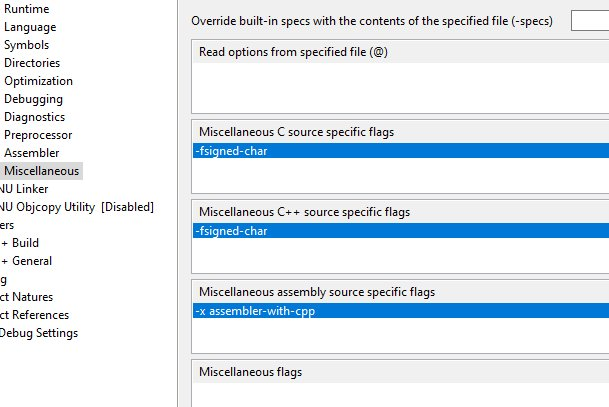

And I have found that the compiler assumes char is unsigned, and yet CCS only let you enable the flag for -funsigned-char.  So these are out of sync.

Why do I think it's supposed to be signed?  Because this flag is NOT set:
So, what is you SET that flag?  No change.
In other words CCS has this flag as an option, that doesn't do anything because the compiler is already defaulting to 'char' being unsigned.
In order to get this to function properly, it is necessary to add this flag:
And it is really necessary to add it to both the C and C++.   When adding that flag, the output is correct.

So, CCS is wrong in making this flag available to the compiler.
My only concern is what settings are the BIOS libraries compiled with in this version, and would they conflict if the main project is set to -fsigned-char (as shown above)...?
