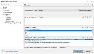

  • Hi Bernd,
    As George mentioned, you can use the hard libgcc.a from ccs1040\ccs\tools\compiler\gcc-arm-none-eabi-9-2019-q4-major\lib\gcc\arm-none-eabi\9.2.1\arm\v5te\hard. You can change the CCS project linker setting to add this to the search path. Right click your CCS project and then choose Show Build Settings... Then choose GNU Linker > Libraries. Then add the full path of the hard libgcc.a to Library search path and add libgcc.a to Libraries, as shown below:

  • Hello Jianzhong,
    thanks a lot for your help - The linking works fine now.
    Just one question. Since we link the cortex-a9 (v7a-architecture) with the v5te-hard library, doesn't the usage of this v5te-library imply quite some performance degradation?

  • The solution is to take the thumb/v7+fp/hard library (${CG_TOOL_ROOT}/lib/gcc/arm-none-eabi/9.2.1/thumb/v7+fp/hard) and enable thumb instructions in the compiler (remove -marm add -mthumb). Additionally add -mthumb-interwork) for -marm compatibility.
