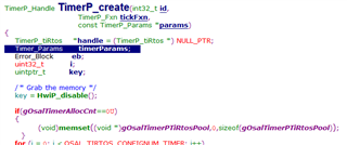

  • “If code is not functioning, recommended next step would be to attach a debugger and follow code path to failure.”
    I try to fined the resaon, search the TimerP_creat in PDK , the function is in two files TimerP_tirtos.c and TimerP_nonos.c,
    Which file will be used?
    Because my woftware is running TIRTOS, so i copied  TimerP_tirtos.c into my folder, compiled failed "timerParams no include intNum", that means there is different between Timer_Params and TimerP_Params, all of these code are in PDK,  should i use "imerP_nonos.c"?
    The reason for referencing the above thread, was to provide another example of TimerP_create() being used, that can be referenced and compared to the code that is being debugged.
    There is no reason to move from using TimerP_create() to directly using Timer_create().
    kb
    "The reason for referencing the above thread, was to provide another example of TimerP_create() being used, that can be referenced and compared to the code that is being debugged."
    you mean that even though the system uses Tirtos, may call the function in TimerP_nonos?
    I just search 2 files include  TimerP_creat.
    "There is no reason to move from using TimerP_create() to directly using Timer_create()."
    Not use Timer_create(), in TimerP_create(), there is a define as below screen shot.
    SDK code for TimerP_creat
    Could you please rephrase the last question, not following the request.
    Regarding original code posted, and failure under investigation, recommendation is to reference a working solution and try to keep the code as similar as possible.  Once "new" sample code is working, then start making modifications to meet the needs of feature development.
    kb
