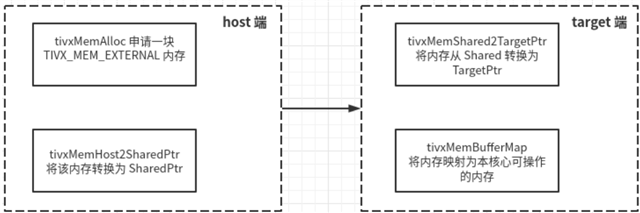

2. How to transfer a large amount of memory from the host end of the A72 core to the target end of the DSP core?
The current operation method is as shown in the figure below. For a large amount of memory that already exists on the host side, it needs to be copied to the memory requested by tivxMemAlloc before it can be transferred to the target side. The overhead is relatively high.
Can the existing memory blocks under Linux be mapped to the ION Shared memory, so as to avoid memory copy overhead?

    I have a few of the answers to your questions below:
    2. The OpenVX framework is used to facilitate the transfer of memory from the A72 to remote cores, including DSP.  The memory is allocated in a DMA Buf FD carveout region of shared memory, allowing you to avoid a buffer copy when doing the transfer.  If you need more information on OpenVX, we have our user guide below, which also includes references to a video series and other papers on the topic.
    https://software-dl.ti.com/jacinto7/esd/processor-sdk-rtos-jacinto7/latest/exports/docs/tiovx/docs/user_guide/index.html
