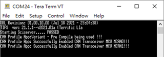

I am trying to tto check GESI Board,but hthere's no CAN signal in sample code "gatewaydemo" use OSPI.
Is there anything needs to be set up?
Please help!!!!
Thanks a lot.

The can_traffic_generator app you are looking at will not use the CAN instances on the GESI card. Do you want to just test the GESI card CAN instances?
If yes, can you take a look at the MCAN board diagnostic test present under pdk*/packages/ti/board/diag/mcan/.
