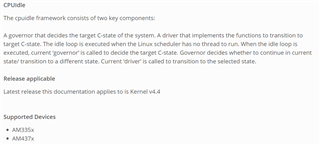

My customer would like to use AM574x (Linux SDK) in low-power consumption configuration and I’d like to ask your help.
Could you please take a look, and give comments on below inquiries?
Q1: As far as I understand, AM574x does not support CPU stand-by mode, is it correct?
On the Processor SDK Linux Software Developer’s Guide, “3.3.4.20 Power Management” does not show AM574x on the CPUIdle supported list.
(https://software-dl.ti.com/processor-sdk-linux/esd/docs/06_02_00_81/linux/Foundational_Components/Kernel/Kernel_Drivers/Power_Management.html)
Q2: When low power consumption is required, the user needs to control Clock or power supply by PRCM, is it correct?
If it is correct, could you share materials explaining clock domain and power domain details?
TRM does not have info on which domain contains which module.
