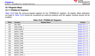

    Data Sheet: https://www.ti.com/lit/ds/symlink/tps6594-q1.pdf?ts=1631081130125&ref_url=https%253A%252F%252Fwww.ti.com%252Fproduct%252FTPS6594-Q1
    C
    heck page 152 for the register map.
    You can check the values using the above command.

    but I am confuse about register map with offset like 0x406
    so how read and write it by i2ctools?
    I think 0x4c is the 4 page slave addr ,so I can get value from 0x406 like
    i2cget -f -y 2 0x4c 0x06
    Is that right?

  • I think 0x4c is the 4 page slave addr ,so I can get value from 0x406 like
    That is correct.
