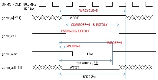

My customer is now evaluating their own board based on AM5706, but they found that the bus error occurred when GPMC accessed FROM. (The connected ICE was frozen.)
They’re using the CS0 area of GPMC and the asynchronous mode (No external wait) with Non-mux data and address. The GPMC internal clock is 66.5MHz, and it’s controlled by the timing like below, but the bus error occurred.
Do you know the cause why the error occurred ?
The GPMC timings are set as follows;
GPMC_CONFIG1_0:0x00001000
GPMC_CONFIG2_0:0x00040980
GPMC_CONFIG4_0:0x04010983
GPMC_CONFIG5_0:0x0008050A
GPMC_CONFIG6_0:0x0F070000
GPMC_CONFIG7_0:0x00000848
The access timing wave could be monitored during write access issue like the above figure. (CS and WE are verified.)
However, the ICE was frozen after that.

  • Hideaki-san,
    Section 15.4.6.1 How to Set GPMC Timing Parameters for Typical Accesses has some timing diagrams to show the expected timing relations.  Table 15-489 GPMC Timing Parameters for Async Single Write in particular seems to fall under customer's use case.
    I noticed CsWrOffTime should be WeOffTime + 1, it is right now set as 4 cycles but should be 5.
    WrCycleTime is WeOffTime + AccessCompletion. AccessCompletion should follow nCS de-assertion time, so WrCycleTime should be programmed with the same value as CsWrOffTime.
    If a higher cycle time works, that could mean the memory device required higher AC timing characteristics.  Are the values set correctly based on the memory device timing?

  • Hi Shiou Mei,
    Thank you for your reply. They’ve tried your suggestion, but the issue has not been solved.
    As you mentioned, they changed CsWrOffTime from 4 to 5 and tried it to run, but the symptom did not improve.
    Also, they tried below.
    After changing CsWrOffTime from 4 to 5,
    • WrCycleTime = 5 since you mentioned that “WrCycleTime” needs to be programmed with the same value as CsWrOffTime”.
    • WrCycleTime = 6 to be longer than de-assert time, because they’re using the shifted nCS by half a clock (CSEXTRADELAY enabled).
    but neither seemed to improve the symptom.
    Also in the case of CsWrOffTime is changed from 4 to 5, it seems that the symptom is improved by changing WrCycleTime to 7, just like when it remains at 4.
    They'd like to clarify the cause of this phenomenon. Are there any other conditions that seem to be related?
    This problem occurs only in the write access. They think that the AM5706 is just issuing and ending, because the external WAIT control is not used. However. It gets into error state (debugger will be frozen.) after the write access waveform appears.
    Could you please help them ? Do you have any idea to solve this issue ?
