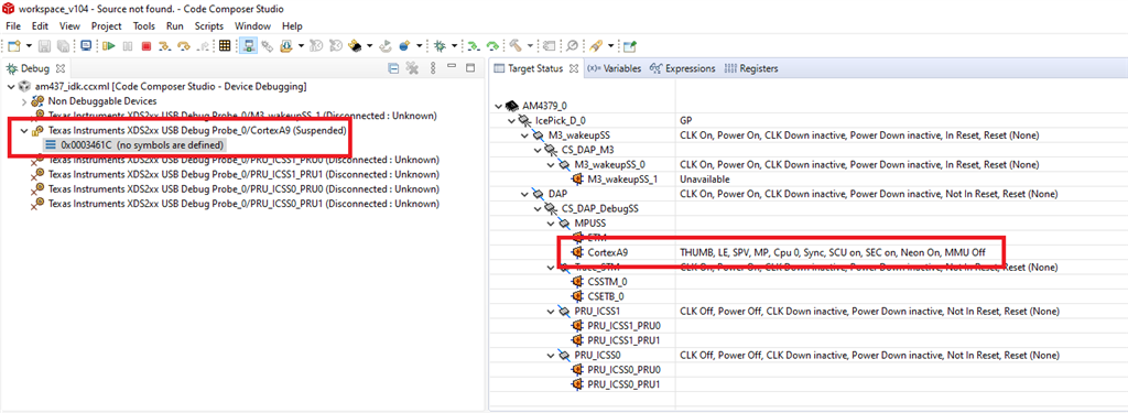

But when we try to connect the A9 core an error occurs, here is the error log:
Error connecting to the target:
(Error -1170 @ 0x0)
Unable to access the DAP. Reset the device, and retry the operation. If error persists, confirm configuration, power-cycle the board, and/or try more reliable JTAG settings (e.g. lower TCLK).
(Emulation package 9.3.0.00042)
Note: We tried to lower the TCLK but it didn't work.
Do we need to configure extra things or upload an extra file? Do you have an idea about the problem that we've faced with?

    Thanks for your help. Yes, It seems we can access the DAP, no error occurs.
    Target status:
    Cortex A9 seems unavailable, is it normal? What can be reason of this?
  • Cortex A9 seems unavailable, is it normal? What can be reason of this?
    That is normal. It is unavailable because you are not connected to the CPU.
    I do not have any issues connecting to the A9:
    I am using the same debug probe settings are you are. There must be some issue with your target. Since the JTAG connectivity test passes, the low level connections are fine. Have you ever been able to connect to this board at all? Or has it never been successful?
    ki
  • It's our first try. It has never been successful before.
  • It is likely some issue with the device state. I will need to have a device expert investigate further.
    We've resolved this issue by removing R11, disconnecting JTAG from SYS_RESETn node. When we connected the XDS200, it kept our SoC in reset.
