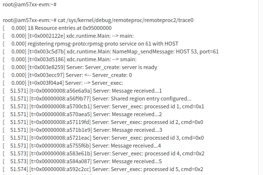

It is pending on sending message 3, it seems that the DSP has no repsonse. It has the same problem when excuting ./app_host DSP1(DSP2/IPU1/IPU2) .

    1. cd /home/ti-processor-sdk-linux-am57xx-evm-06.03.00.106
    2. make linux-dtbs
    When he executed ./app_host HOST and ./app_host DSP1, it can receive data. But DSP2, IPU1/2 are still stucking at "sending message 3", then excuting the ./app_host HOST again, it occurred the same error.

  • Hi Shine,
    The SDK 6.3 loads the firmwares at SPL. So, please make sure the firmwares are changed and board is rebooted before running the test.

  • Hi Suman,
    I looked at the link you gave me. It is very similar between two situations. However, when I use the command ls -l /lib/firmware | grep lrw
    Here is different in two board.
    You can see that the two soft connections correspond to server_dsp.xe66. Because I want to use DSP2. I suppose it will work, but actually it not. Only
    DSP1 can be used. And my print information much less than the other one.
    I do not have server_dsp1.xe66 & server_dsp2.xe66 & server_ipu1.xem4 & server_ipu2.xem4 except server_dsp-.xe66 in
    the /usr/bin/simple_buffer_example/release/
    How to use dsp2 and ipu1/2? How can I create a soft link in this release directory?

  • Hi Yubo,
    The simple_buffer_example executables in the SDK are being built only for DSP1, and not any other core. So, the firmware image cannot be used as is on DSP2. You would have to modify the source code and build new firmwares if you want to run that example of DSP2.
    Please use the fimrwares from /usr/bin/ipc/ex02_messageq/release folder, and the corresponding app_host Linux-side executable.

  • Hi Suman,
    Thank you for your reply and help. I think I have solved the problem of messageq, but I have other problems about bigdata. I have raised questions in another
    post.
