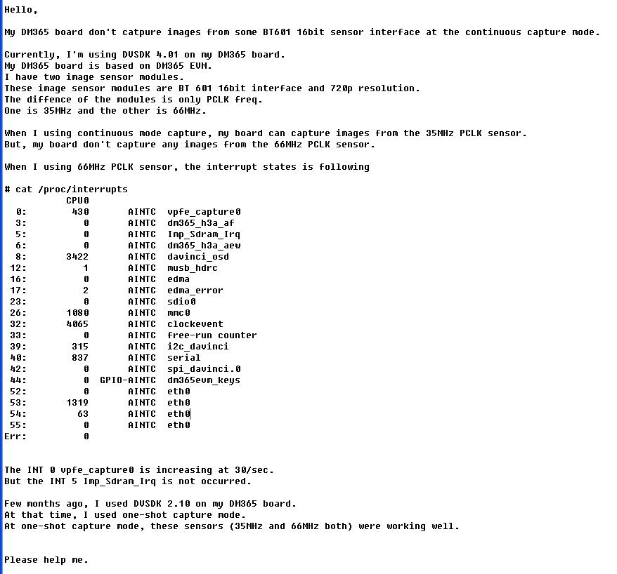

Hello, My DM365 board don't catpure images from some BT601 16bit sensor interface at the continuous capture mode. Currently, I'm using DVSDK 4.01 on my DM365 board. My DM365 board is based on DM365 EVM. I have two image sensor modules. These image sensor modules are BT 601 16bit interface and 720p resolution. The diffence of the modules is only PCLK freq. One is 35MHz and the other is 66MHz. When I using continuous mode capture, my board can capture images from the 35MHz PCLK sensor. But, my board don't capture any images from the 66MHz PCLK sensor. When I using 66MHz PCLK sensor, the interrupt states is following # cat /proc/interrupts CPU0 0: 430 AINTC vpfe_capture0 3: 0 AINTC dm365_h3a_af 5: 0 AINTC Imp_Sdram_Irq 6: 0 AINTC dm365_h3a_aew 8: 3422 AINTC davinci_osd 12: 1 AINTC musb_hdrc 16: 0 AINTC edma 17: 2 AINTC edma_error 23: 0 AINTC sdio0 26: 1080 AINTC mmc0 32: 4065 AINTC clockevent 33: 0 AINTC free-run counter 39: 315 AINTC i2c_davinci 40: 837 AINTC serial 42: 0 AINTC spi_davinci.0 44: 0 GPIO-AINTC dm365evm_keys 52: 0 AINTC eth0 53: 1319 AINTC eth0 54: 63 AINTC eth0 55: 0 AINTC eth0 Err: 0 # The INT 0 vpfe_capture0 is increasing at 30/sec. But the INT 5 Imp_Sdram_Irq is not occurred. Few months ago, I used DVSDK 2.10 on my DM365 board. At that time, I used one-shot capture mode. At one-shot capture mode, these sensors (35MHz and 66MHz both) were working well. Please help me.
  • Ooops!!! Why my post is above ???? So I make my post as image file.

    Thanks for your reply.
    > 1. Are you configuring the resizer with the right input size that you are receiving from sensor/ISIF?
    Yes.
    I'm running using same HW, same kernel, same drivers, and same test app for 2 diffent sensor modules.
    35M PCLK sensor is working well. But, 66M PCLK sensor is not.
    My test app is base on encode in DVSDK 4.01 psp. I removed some codes related with display & graphic.
    This app captures from sensor at 720p resolution and encode to H.264 and save encoded data to file. ( at continuous mode)

    > 3. Can you try reducing the output resolution from the resizer in the capture driver and see if you start getting some interrupts or not?
    I change resizer output image resolution as 640 x 352.
    My test app working well at 65MHz PCLK sensor.
