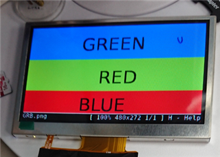

My customer is trying to connect LCD panel to SPI port on AM64x SKEVM.
But when pixel data are sent by DMA, the color on LCD panel is not correct.
If the data is sent PIO (DMA disabled), the color is correct.
Below patch is used to disable DMA.
(please change *.txt to *.patch)

Customer also tried to use other processor (RasberryPI4) with the same LCD panel and it worked fine with DMA enabled.
So customer suspects something wrong in TI driver.
