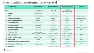

    Thanks for the response , thanks you mentioned about the ESR values , the AM3358BZCZ100 specifies to use a an crystal with Max ESR 48 Ohm ,
    So can i use use an Crystal with ESR of 30 Ohms, Please see the attached Datasheet of Exctal ,
    Also can you suggest the most suitable Crystal among
    AA-24.000MAHJ-T and ECS-240-18-30-JGN-TR
    AA-24.000MAHJ-T.pdf
    ECS-240-18-30-JGN-TR.pdf
  • You neve said if you were using RMII and needed 50 PPM system performance. Therefore, I cannot comment how were these options align with your system requirements.
    I noticed the Digi-key description for your existing crystal, which they are selling under part number 7A-24.000MAAJ-T was cut for an 18pF load, so it must not be one of the standard options shown in the datasheet. What load did you apply to this crystal in your product? Are you willing to change load capacitor values in your product when you change crystals? How much capacitive load does you signals apply to the crystal circuit?
    I do not think a crystal cut for 18pF load was ever appropriate for AM335x. Each load capacitor would need to be approximately 33 - 36 pF to achieve a 18pF load for the crystal and the AM335x datasheet only allows load capacitors in the range of 12 - 24 pF.
    The highest load capacitance crystal you would be able to use is 12pF to remain in the ranged defined by the AM335x datasheet.
    The AA-24.000MAHJ-T datasheet shows their standard offering is a crystal cut for a 8pF load. However, they provide an option to specify a load capacitance. I did not see an aging parameter in this datasheet, so not sure how PPM will change over time on this crystal.  It may be a viable option as long as you apply the correct load capacitance for the crystal your purchase while remaining compliant with AM335x datasheet. However, you should validate startup reliability using the method described previously to ensure ESR in not going to be a problem.
    The ECS-240-18-30-JGN-TR datasheet does not clearly show an option for buying a crystal cut for a lower capacitive load and 20 pF is too high. You may be able to use this as a viable option if they would sell you one that was cut for 10 pF.
