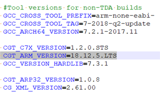

  • Hello.
    thank you for your reply.
    You have performed steps 1-5.
    In step 5, the following command was executed.
    gmake BOARD = idkAM571x CORE = a15_0
    The following error occurred.
    Is my procedure wrong?
    (My environment is windows)

    C:\ti\pdk_am57xx_1_0_15\packages>cd C:\ti\pdk_am57xx_1_0_15\packages\ti\board
    C:\ti\pdk_am57xx_1_0_15\packages\ti\board>gmake BOARD=idkAM571x CORE=a15_0
    gmake libcores BOARD=evmAM572x
    gmake[1]: Entering directory 'C:/ti/pdk_am57xx_1_0_15/packages/ti/board'
    gmake lib_allendians CORE=c66x BUILD_PROFILE_c66x=release
    gmake[2]: Entering directory 'C:/ti/pdk_am57xx_1_0_15/packages/ti/board'
    gmake comp_libs ENDIAN=little
    gmake[3]: Entering directory 'C:/ti/pdk_am57xx_1_0_15/packages/ti/board'
    gmake -C C:/ti/pdk_am57xx_1_0_15/packages/ti/board -f build/makefile.mk
    gmake[4]: Entering directory 'C:/ti/pdk_am57xx_1_0_15/packages/ti/board'
    gmake[4]: Nothing to be done for 'all'.
    gmake[4]: Leaving directory 'C:/ti/pdk_am57xx_1_0_15/packages/ti/board'
    gmake[3]: Leaving directory 'C:/ti/pdk_am57xx_1_0_15/packages/ti/board'
    gmake[2]: Leaving directory 'C:/ti/pdk_am57xx_1_0_15/packages/ti/board'
    gmake lib_allendians CORE=a15_0 BUILD_PROFILE_a15_0=release
    gmake lib_allendians CORE=ipu1_0 BUILD_PROFILE_ipu1_0=release
    gmake[4]: *** No rule to make target 'C:/ti/ti-cgt-arm_18.12.1.LTS/include/stdint.h', needed by 'C:/ti/pdk_am57xx_1_0_15/packages/ti/binary/ti/board/board/obj/evmAM572x/m4/release/board.oem4'.  Stop.

    Looks like stdint.h is missing. Can you please check if stdint.h is available at C:/ti/ti-cgt-arm_18.12.1.LTS/include?
    Parth
  • Hello.
    The folder "C:/ti/ti-cgt-arm_18.12.1.LTS/" does not exist.
    Instead, there is "C:/ti/ti-cgt-arm_16.9.6.LTS/include/stdint.h".
    Where should I fix it?
    thank you.
    You can change the  CGT_ARM_VERSION to 16.9.6.LTS in C:\ti\pdk_am57xx_1_0_15\packages\ti\build\pdk_tools_path.
    Also, you can try installing the latest SDK, where all these dependencies are taken care by pdksetupenv script.
    Parth

    Changed two "CGT_ARM_VERSION" to "16.9.6.LTS".
    As a result of gmake, the same error occurred.
    Where should I fix it after that?
    thank you.
    This should work properly. What error are you getting with this modification?
