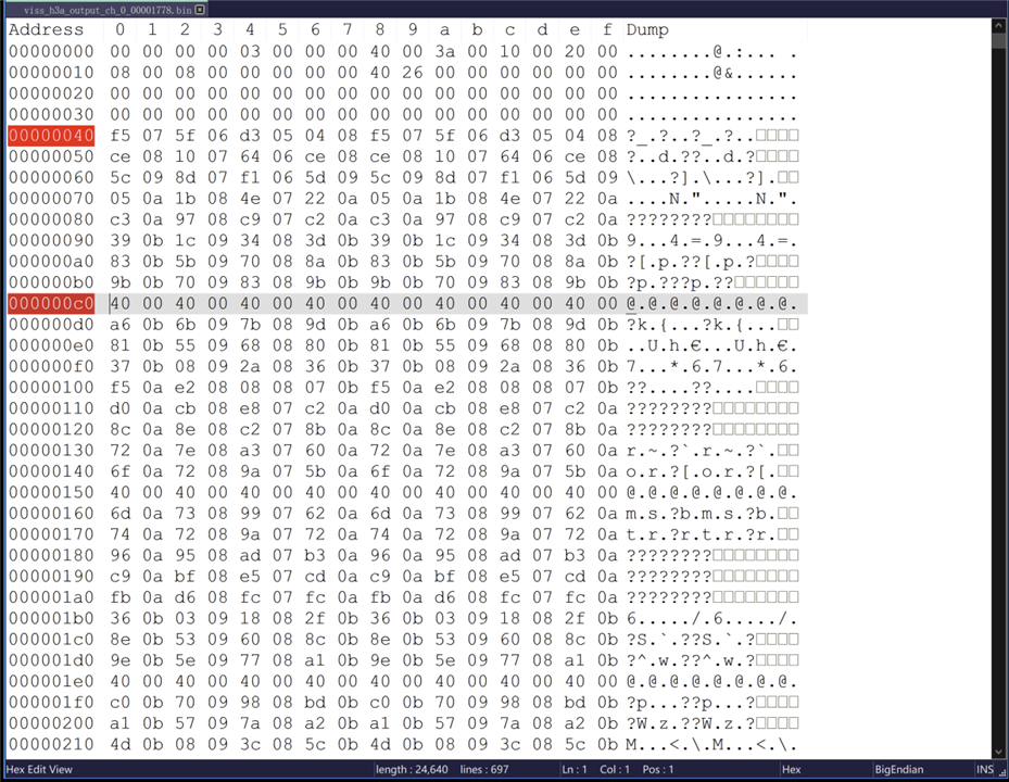

I used multi_cam app to capture and get .bin file of H3A output. I want to analyze this file to optimize my 2A algo. Could you help me to understand the data field definition? Please refer the .bin and H3A xml files I attached. The sensor output resolution is 1920x1280.
For my understanding,
1. The initial 64 bytes of this .bin file may be the header.
2. The data should be the mapping to RAWFE H3A AE/AWB Packet Format. I used Sum-Only Mode, so the data should be mapping to the format which is showed in TRM Table 6-5335 (page 5803-5804)
Please correct me if I was wrong and help explain the data definition of .bin file.
Thanks.
Zhishen

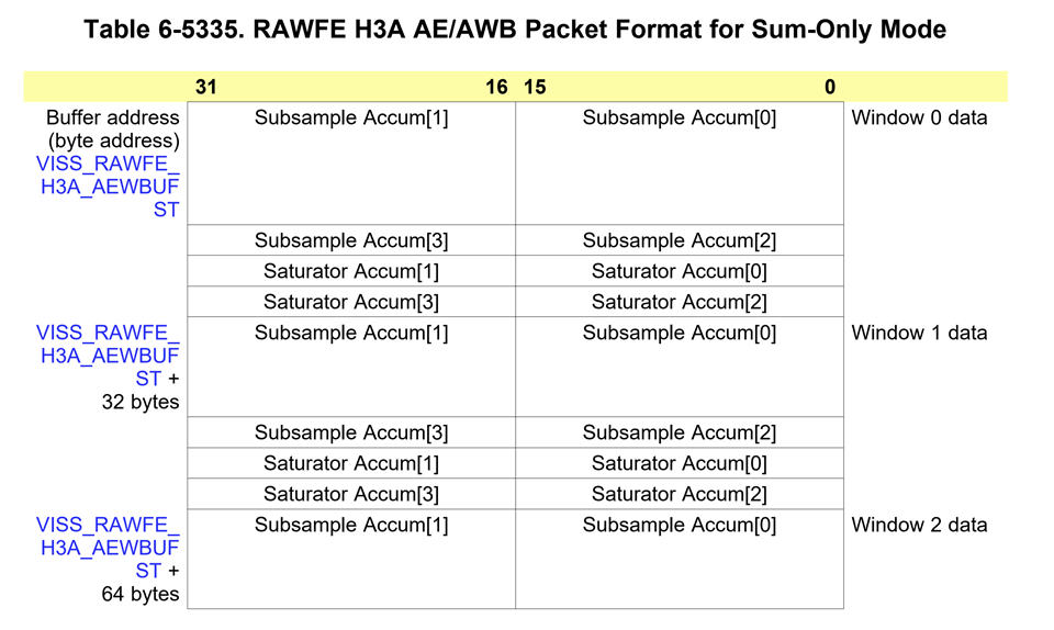

  • Hi Zhishen,
    That is for skipping the 0 padding in H3A data packet.
    Please refer to the table 5335 "H3A AE/AWB Packet Format for Sum-Only Mode" you copied above for the details of the data packet.
    Gang
  • Hi Gang,
    I analyzed .bin file to verify Table 6-5335. I still have some questions. The attachment is the HEX show of .bin file.
    1. The started 64 bytes may be 'header' of this .bin file. Are there details of the 'header'?
    2. According to Table 6-5335, 1 window occupies 32 bytes. From snapshot of .bin file, I think window0 is from address 0x40 to 0x4f which occupy 16 bytes. Is there conflict?
    3. Please refer to the snapshot. My understanding is that window0 to 8 data is from address 0x40 to 0xbf. Unsaturated block count for window0 to window8 is 0xc0 to 0xcf. Please correct me if I was wrong.
    Thanks.

  • Hi Gang,
    Please refer to the zip file I attached before. You can find the bin file I captured with multi camera app. The PSDK I used is 7.1.
    Zhishen
  • Hi ZS,
    That makes sense.
    Multi-cam camera app must have added a header of 64 bytes while saving to files.
    You may ignore those 64 byes completely.
    If you use the single-cam app, there is no header at all.

  • Hi ZS,
    You are correct on both; so I don't need to correct anything.
    Please follow the content of Table 6-5335.
    (2) 4 rows of 32-bit words = 16 bytes
    (3) 8 windows x 16 bytes/window = 128 bytes
  • Hi Gang,
    Please refer to Table 6-5335 again. In the left side, VISS_RAWFE_H3A_AEWBUFST is the started address in SDRAM for H3A buffer, right? Windows 0 data start from here. Windows1 data start VISS_RAWFE_H3A_AEWBUFST+32bytes. Therefore, I thought single window occupy 32 bytes. But it seems like a conflict to the bin file I showed. E.g., from sanpshot, window0 data is from 0x40 to 0x4f and window1 data is from 0x50 to 0x5f which are 16 bytes. That is what I confused.
    A further question is based on the one above. I assume 16 bytes per window so 8x16+16=144 bytes per 8-window. My H3A setting is:
    16, // v_count
    32, // h_count
    Therefore, valid H3A data is [(32x16)/8] x144 = 9216 bytes
    Back to .bin file, valid data is from 0x40 to 0x2680 so it occupies 9792 bytes. They are different. Could you help check it?
    Thanks.

  • Hi ZS,
    The "+32" looks like copy/paste error since in the other 2 modes each window has 32 bytes.
    Please focus on the contents of the table on the right side: there are 4 rows of 32-bit words --> 16 bytes.
    The parser code in PSDK makes this clear as well.
    Again, please follow the table and parser code.
    We discussed above that there are extra 0 padding included in the data.
    Therefore, the actual size is larger than 9216.

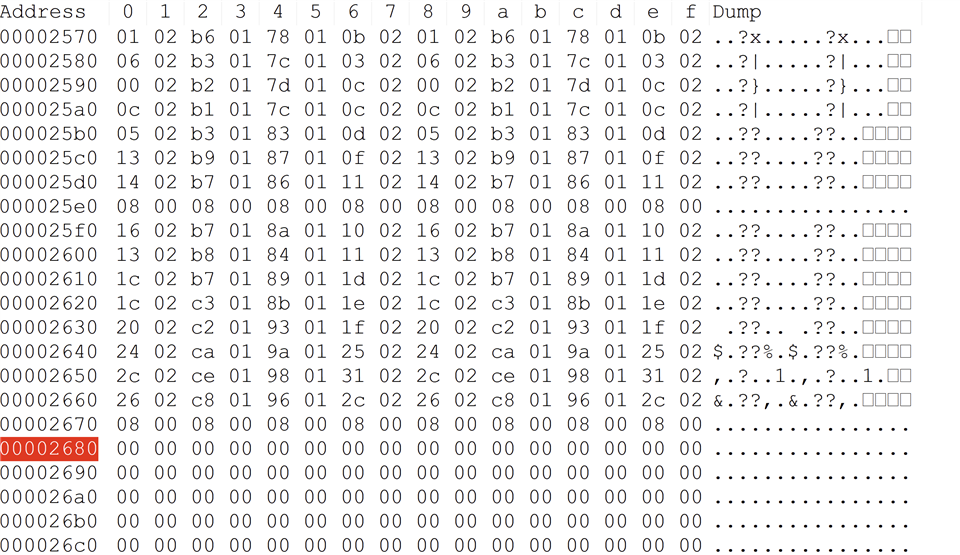

  • Hi Gang,
    I checked my bin file again.
    For "parse_h3a_out( )", the following part,
    if ((cur_addr - h3a_buf) % 32 == 16)
                cur_addr += 16;
    I cannot match 0 padding in my bin file. From address 0x40 to 0x2680, there are not continunous '00' padding. Besides some padding in header, the next one is after 0x2680 (valid data is from 0x40 to 0x2680). Could you help check it if code had bug?
    For the difference between actual valid data size (9792 bytes) and calculating value (9216 bytes), I think it may make sense.
    [(9792-9216)/144]*8=32
    32 is same as H_count. Therefore, valid data size of this bin file is for 32 (H)x17(V) which equals to 9792 bytes
    [(32x17)/8]*144=9792 bytes
    Zhishen
  • Hi ZS,
    Don't worry; the code is correct and has been used and tested for more than 15 years by thousands of customers.
    The relevant information for customers is the parser code output of R/G/G/B sums.
    You are correct that there are 32 (8x) windows on each row, so there is no 0 padding in between.
    There are 16 rows of data for normal windows that you actually use and 1 additional row of black windows at the end (see 6.10.4.3.4.6.6.2).
    The black row is only useful for very old sensors from more than 15 years ago, but H/W still require additional buffer size for output.
    So, the parser code ignores the black row completely.
