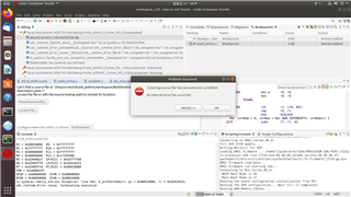

when i am loading program with CCS,It will appear as shown below:
I don't know why? The CCS version is 10.4.0.00006, the program is can_boot_app_mcu_rtos_mcu1_0_debug.xer5f for mcu1_0 of TDA4VM.
please help me, thanks.

Can you mention the steps you are following for CCS initialization/binary loading?
Please refer this for more information.
I have never seen such a message from CCS. Do you have any additional Eclipse plug-ins installed?
If you press the "Details>>" button, are there more messages?
Can you also provide the Eclipse error log? It can be found in <WORKSPACE FODLER>\.metadata\.log ?

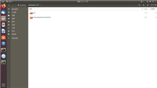

I shouldn't actively install any Eclipse plugins unless accidentally.The Details>> button is shown in figure 1.The directory structure of my CCS workspace is shown in Figure 2, I did not find the file \.metadata\.log, it is empty. Is this a problem with the CCS project I created? I followed the steps in the document in that link.Could it be that I neglected some parts ?
Figure 1:
Figure 2:
I believe Linux will consider any file/folder that starts with "." as hidden. You will need to change the system setting to show hidden files/folders:
https://websiteforstudents.com/how-to-hide-and-unhide-files-with-ubuntu-desktop/
