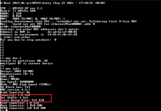

We are doing custom board design with TI’s AM3352BZCZA30 processor. We have used eMMC part number MTFC2GMDEA. This part is 2GB in size and supports 8 bit bus width.
We have connected this eMMC on pins GPMC_AD8 to GPMC_AD15 and set pinmux for mmc1_dat0 to mmc1_dat7 (Mux Mode 2) as shown in the below figure and set the mentioned below pinmux.

When we try to detect the eMMC on U-boot we can see it is configuring only 1 bit bus width. It is showing in below figure.
If we connect this same eMMC on pin GPMC_AD0 to GPMC_AD7 and set pinmux for mmc1_dat0 to mmc1_dat7 (mux mode 1) then I can see bus width set as 8-bit in the u-boot.
Can you please let me know what I am missing here to make this eMMC 8 bit on GPMC_AD8 to GPMC_AD15 ?
