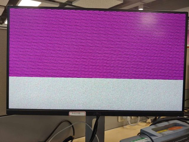

We use PSDKR v7.2, and created a sensor driver to receive RGB888 colorbar which generated by our serializer(MAX97717F), it works.  [CASE 1]
Then we tried receiving RAW12 stream generated by CSITx example in PDK, it works too. [CASE 2]
But when set APP_TX_IMAGE_DT to FVID2_CSI2_DF_RGB888, and APP_TX_FRAME_BPP to 4 in csitx_transmit_test_cfg.h, we got incorrect display: [CASE 3]
We use {VX_DF_IMAGE_RGBX, 23} in CASE 1, so I tried {VX_DF_IMAGE_RGB, 23} in our sensor driver, but there is no display and FPS is 0.
I also tried setting APP_TX_FRAME_BPP to 3 in CSITx example, but got error output:

  • Hi Keelung Yang,
    Bit confused. Are you talking about CSIRX or CSITX? Because case1 and case2 look like CSIRX test case, whereas case3 is for CSITX.
    RGB888 is supported, but please note that 24bit pixel should be stored in unpacked 32bit format.

  • Hi Keelung Yang,
    You could need to change data type to RGB32 (like ARGB of RGBA) and then change to BPP to 4. This should work fine.

    I've set APP_TX_IMAGE_DT to FVID2_CSI2_DF_RGB888, and APP_TX_FRAME_BPP to 4 in csitx_transmit_test_cfg.h, and got incorrect stream on display(the snapshot is posted on top of this thread)
    Since CASE1 and CASE2 work, I focus on csitx_transmit_test app in CSITx driver example.
    After digging it, I'm confued about inFmt.dataFormat and outCsiDataType fields in Csitx_ChCfg:
    In csitx_transmit_test app, inFmt is hard-coded to FVID2_DF_BGRX32_8888, that's why CSL_REG32_WR() is used to set pixel data?
    But outCsiDataType is in FVID2_CSI2_DF_RGB888 now or FVID2_CSI2_DF_RAW12 by default, and then how CSITx driver can convert FVID2_DF_BGRX32_8888 to FVID2_CSI2_DF_RGB888 or FVID2_CSI2_DF_RAW12?
    On the other hand, according comments in drv/csitx/csitx.h, FVID2_DF_BGRX32_8888 is not even a supported pixel format:
    So what the relation between inFmt.dataFormat and outCsiDataType ?

  • Hi Keelung Yang,
    The only usage of the dataFormat is to determine ordering of luma and chroma component for YUV422 format, as the comment says. It is not used otherwise. The format is otherwise determined from the outCsiDataType  variable only.
    For the RGB data, as explained in the TRM, below is only format supported in the TX. So please make sure to store the data in this format.
