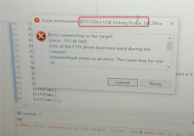

    Thank you for uploading the video. A few observations:
    1) I see that CCS is configured for an XDS100v3. This is incorrect since your debug probe is an XDS560v2. The correct connection type should be "Blackhawk XDS560v2-USB System Trace Emulator"
    2) I see the MODE LED as BLINKING GREEN. It means it is booting up. Does it ever become a SOLID GREEN?

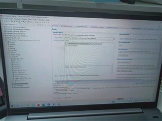

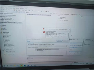

          I reconfigured it and took a new video. Please check it out. The important thing is that the emulator is not enumerated as a USB device. No "unknown device found" or any other message popped up.And the MODE LED  never never become a SOLID GREEN.
        I bought a new one on your official website and tried it on arrival today. There is no problem. The computer can recognize USB insertion,and the MODE LED  become a SOLID GREEN,Please check out my new video for more details.But the emulator I bought from Mouser didn't recognize USB inserts,and the MODE LED  never become a SOLID GREEN,and I switched the USB cable from the good emulator to the bad one,he indicator light was still blink green.It must be that the simulator is broken, Please help me to return the simulator, thank you!
  • Thank you for the latest updates. The issue is specific to that particular probe. As mentioned by TI support in your original post, please coordinate with Mouser to get a replacement probe. You will need to contact them directly.
