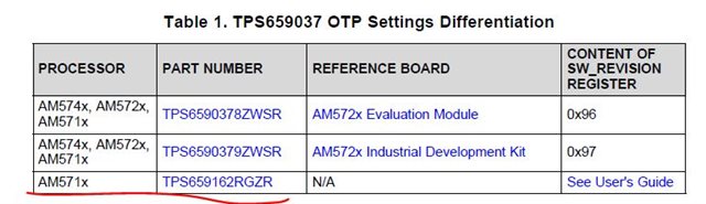

From the table from TPS659037 user guide to power AM57...., can use TPS65916 to power AM571x,
Question:
#1. Is there TPS65916 software driver in current Processor SDK to support AM5716? I did not find TPS65916 information in any AM57xx dts file.
#2. If not, will TI help to provide driver, configuration file? or need customer implement it by themselves?
#3. What is TI's official suggestion on AM57xx PMIC selection? counting in cost and software effort.
  • #1: Do you see '917 in the Processor SDK?  The AVS config is the same for that component as the '917.
    #2: If the design follows the EVM then it should just work.  If any issues TI can support on e2e as always.
    #3: The appnote covers the recommended PMIC selection.
    Kyle
